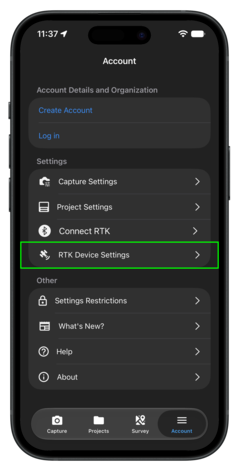

  1. Open RTK Device Settings from the main menu in PIX4Dcatch.
    RTK device settings

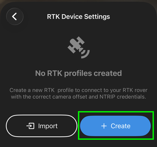

  2. Tap Create.
    Create RTK profile

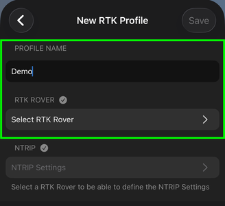

  3. Enter a Profile Name.
  4. Select the RTK receiver to be associated with the profile.
    New RTK profile

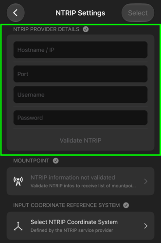

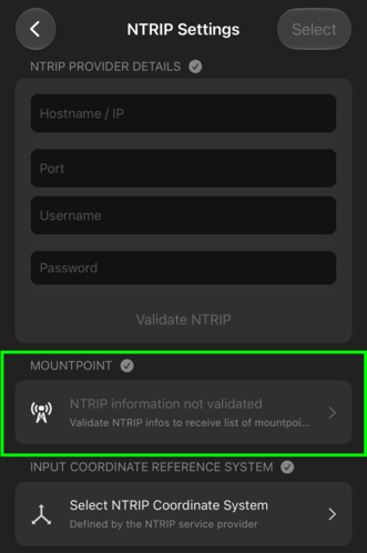

  6. Enter the NTRIP Provider Details.
    NTRIP credentials
  7. Select the Mountpoint. The correct mountpoint will depend on your NTRIP provider and region.
    mountpoint

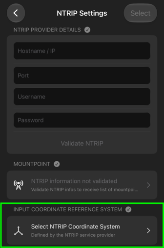

  8. Select the Input Coordinate Reference System. The correct input coordinate reference system will depend on your provider and region.
    Input CRS for NTRIP

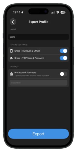

Exporting an RTK profile
  1. In the RTK Device Settings, select the desired Profile.
  2. Tap the export icon  Export icon.
    Export RTK profile
  3. Select one or more export options from the menu:
  • Share RTK Rover & Offset – Shares the RTK rover and the camera offsets used in the RTK profile.
  • Share NTRIP User & Password – Shares only the server address, username, and password for the NTRIP connection.
  • Protect with Password – Secures the profile with a password which is required at import. Passwords must not include spaces or commas.
       6. Tap Export and choose a method to save or share the JSON file.
             Export RTK profile
