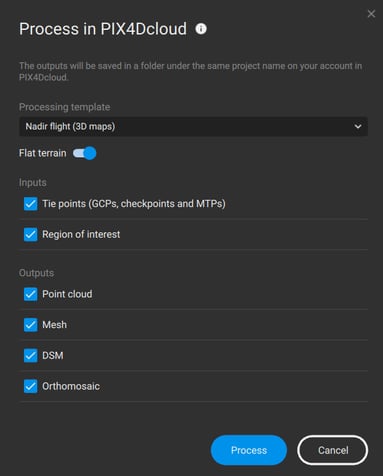

The Process in PIX4Dcloud window will pop up.
PIX4Dclod_process_2.6
Note: Tie points and Regions of Interest are taken into account when processing the project on PIX4Dcloud

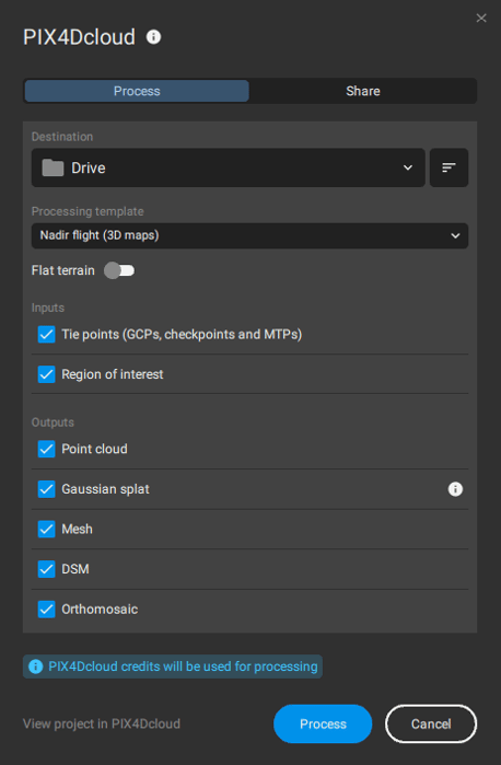

The available Processing templates, Inputs, and Outputs are displayed in this window and explained in the table below:
Destination
  • Place where sites and datasets can be created.
Processing  template
  • Nadir flights (3D maps): Recommended for projects with nadir imagery
  • Oblique flights (3D models): Recommended for projects with oblique imagery
  • PIX4Dcatch: For PIX4Dcatch projects, the PIX4Dcatch template will be automatically selected and cannot be modified
Flat terrain
  • Enabled: Recommended for nadir flights with low-texture images or including a repetitive pattern
  • Not available: For oblique flights or projects captured with PIX4Dcatch
Inputs (available only if the project contains the respective input)
  • Tie points (GCPs, checkpoints, and MTPs)
  • Region of Interest
Outputs (available only if the project contains the respective input)
Note: Gaussian splatting is available for PIX4Dcatch projects and drone datasets when they are processed in PIX4Dcloud. Since PIX4DMatic 2.3.0, under PIX4Dmatic Pro license,  Gaussian splatting can be processed in PIX4Dmatic.
After selecting the desired option in the Process in PIX4Dcloud window, click on Process to start processing.

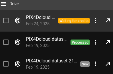

What will happen if I have insufficient credits?
  • When credits are insufficient to complete the processing in PIX4Dcloud, the upload will fail, and a red warning will be displayed in the Status Bar of PIX4Dmatic. Additionally, selecting View project in PIX4cloud will lead to an error page in PIX4Dcloud.
  • The project will be uploaded but remain in a Waiting for credits state. The project will be visible in PIX4Dcloud, the processing will start automatically when sufficient credits are added.
