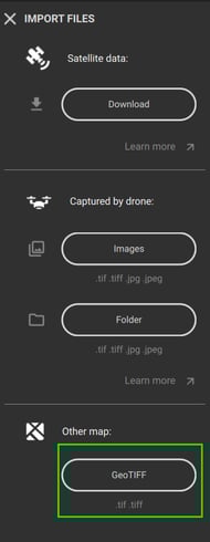

Download and import Orthomosaic to PIX4Dfields
Download the example layer "Sorghum&Peanuts.tif" and import it into PIX4Dfields:
  1. On the dashboard, click + New Project or the + symbol at the bottom right corner of the window.
  2. A new window with a background satellite image appears.
  3. Click the pen symbol beside the default name of the project to rename the project.
  4. Under Other map, click GeoTIFF.
    Import GeoTiff in PIX4Dfields
  5. Select the example file "Sorghum&Peanuts.tif" and click Open.
  6. The Orthomosaic is imported successfully.

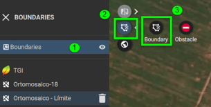

Create a boundary
  1. Click the Boundaries layer on the left board above the layer list to enter the boundaries mode.
  2. To draw a field boundary, click the Draw boundary icon in the left corner of the map.
  3. Select Boundary. Note that obstacles can be created as well.2024-09-02_15-29-59
  4. Left-click to start drawing.
For more information: Field boundaries and obstacles - PIX4Dfields.

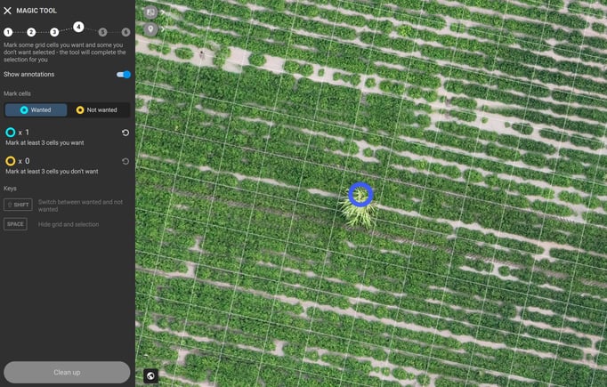

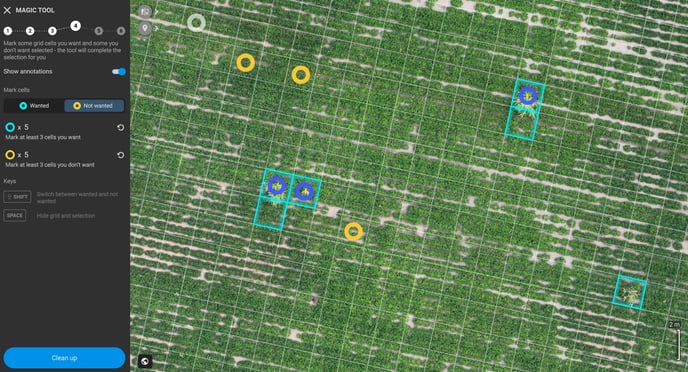

    6. Labeling:
      Manually identify areas of weeds and crops by clicking on them within the boundary:
      1. Weeds: Click Wanted and click on at least 6 cells representing weed areas. (blue)
      2. Crops: Click Not wanted and click on at least 6 cells representing crop areas. (yellow)
      3. Purpose: These sample points help the Magic Tool distinguish weeds from crops based on visual patterns and color differencesExample of the Magic Tool in PIX4Dfields

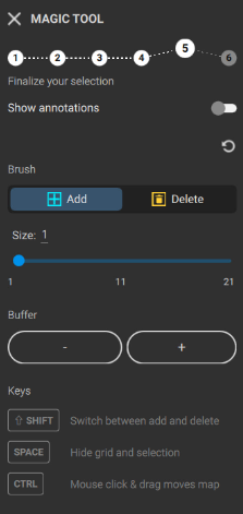

    7. Clean up:
      In Step 5, clean up the selection manually and add or delete cells. Incorporate a buffer by selecting the + icon; this will help ensure that the surrounding areas of the weed nests are effectively treated during the spraying process.
      5th_CleanUp

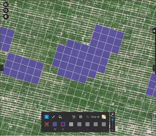

    8. Convert the results into an operation layer. This step completes the weed detection process, resulting in an operational layer that provides valuable insights for targeted herbicide applications or additional analysis.
      SorghumDetection
