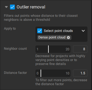

outlier_removal_2.0
The filter is controlled by two main parameters: distance factor and number of neighbors.
  • Number of Neighbors (From 1 to 20. By default 8): This setting defines how many nearby points the filter considers when calculating the average distance for each individual point.
    • A high setting for the number of neighbors makes the filter more robust to local variations in point density because it considers a larger group of points.
    • A low setting is useful for projects with highly varying point densities or when you need to preserve fine details, as it only considers a small, localized number of points.
  • Distance Factor: (From 0 to 10. By default, 1.5): This is the threshold for flagging a point as an outlier. It determines how far away a point must be from its neighbors relative to the average distance of the entire point cloud.
    • A high setting means the filter is very forgiving; a point must be extremely far away to be considered an outlier. This will remove fewer points.
    • A low setting makes the filter stricter; a point does not have to be very far away to be removed. This will result in more points being filtered out.

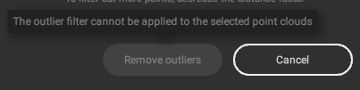

Important: If no input is selected, the Remove outliers button remains disabled, and a message appears when hovering over the button.

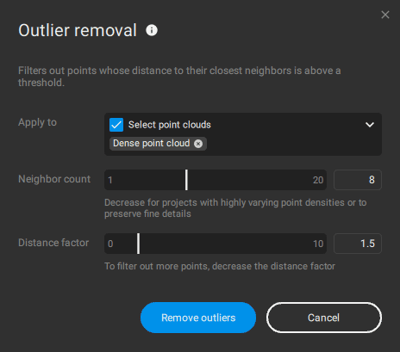

To use the outlier removal filter:
  1. Entire point cloud. To apply the outlier removal for the entire point cloud selected as input, navigate to Process > Outlier removal...
  2. Selected point cloud. The outlier removal filter can be applied to a specific area. First, select the desired area using any of the selection tools. Then, right-click the button, and Remove outliers...
Note:  In both cases, the same menu will appear to adjust the parameters.
