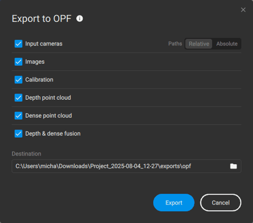

To export a project in OPF, go to File > Export > Project as OPF…
Select all files to be included in the project.opf file.
Export OPF options

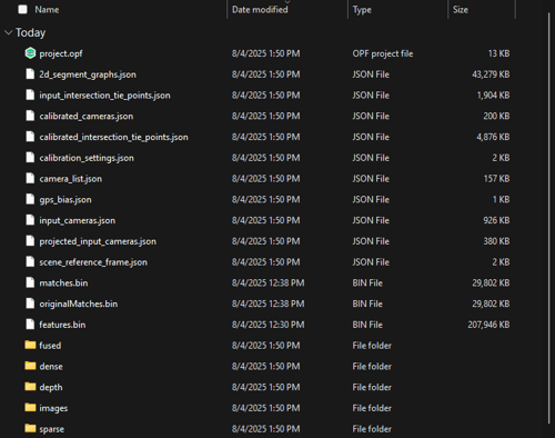

An “opf” subfolder is created within the export directory after export.
OPF folder contents
The project.opf opf file serves as an index referencing all other files in the project. This file can be opened in PIX4Dmatic or potentially used in other supported software.
