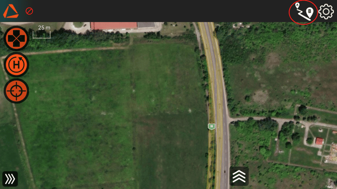

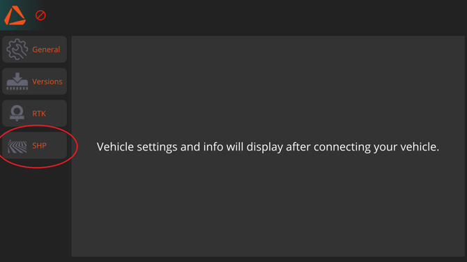

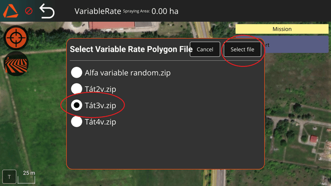

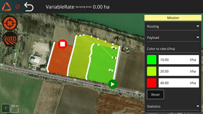

Import the map into the controller
After exporting the desired format from PIX4Dfields:

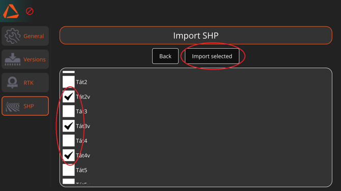

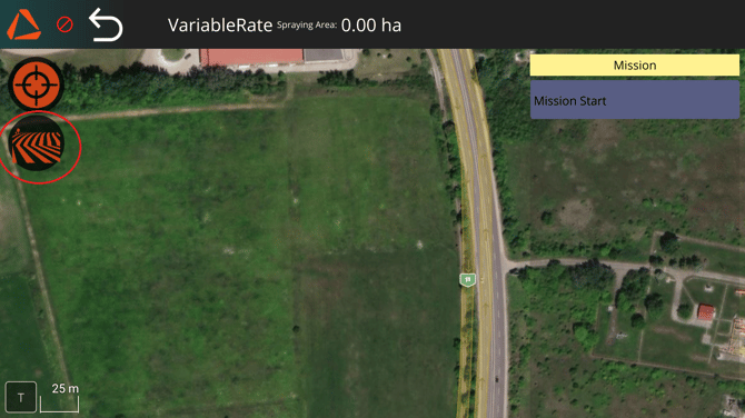

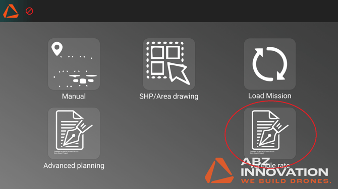

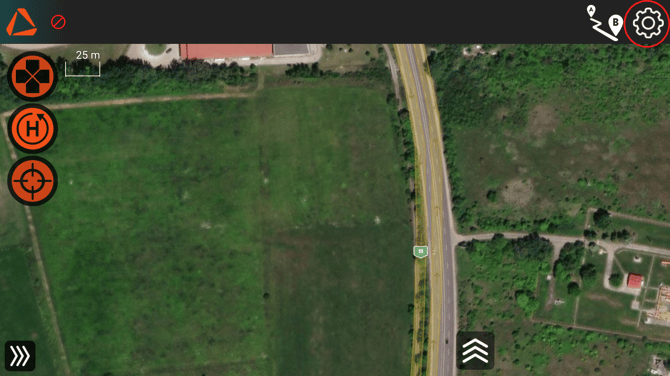

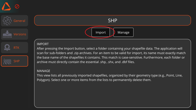

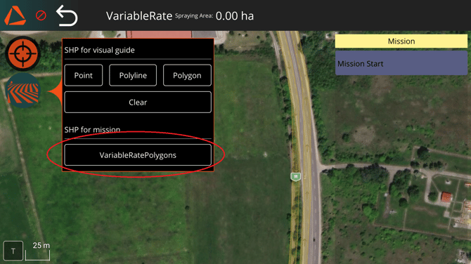

  • Copy and paste the folder onto the micro SD card.
  • Remove the SD card from the laptop and insert it into the controller. Then, power on the controller and import the files.
