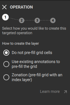

After creating the boundary, create a Targeted Operation by clicking Operation.
  1. Select Do not pre-fill grid cells.
    2024-08-30_13-41-00

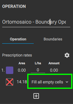

  5. Assign a rate, which can be changed in the remote controller as well.
  6. Click Fill all empty cells and select 1. Rate.

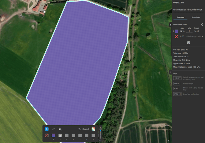

    2024-08-30_13-48-35
  7. Final operation:222

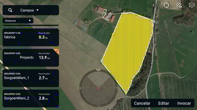

  • Click on the SD Card icon, and choose Shapefile.
  • Select the proper boundary and click Import.
  • The boundary is imported and the application can be planned:WhatsApp Image 2024-09-03 at 13.40.56
