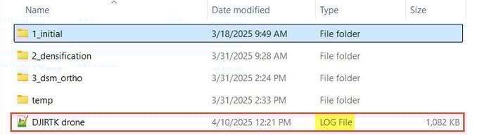

Accessing the Log File
To find the log file:
  • Click on the Open Results Folder.
    PIX4Dmapper resultd folder location
  • The results folder will open. Look for a log file with the .txt extension.
    PIX4Dmapper_Logfiles_location
