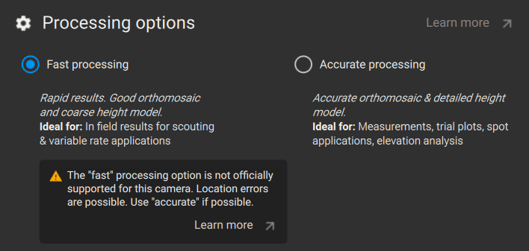

"Fast processing option not officially supported" warning - PIX4Dfields
Introduction
This warning appears when the camera in use is not officially supported, and its EXIF metadata lacks reliable information. In these cases, only the physical pixel size and an approximate focal length extracted from the EXIF data are available.
Other essential internal parameters, such as accurate lens distortion coefficients and the exact principal point, are assumed or set to standard defaults, like centering the principal point on the sensor.
As a result, the processing pipeline is unable to fully optimize the camera's internal geometry, especially when running in fast processing mode.
Can I still process these images?
Yes, images may still be processed; however, be aware that output accuracy could be lower than expected, and anticipate possible degradation in the precision of the resulting map.
For optimal results, we recommend:
- Selecting Accurate processing.
- Using officially supported drones and cameras if possible.
