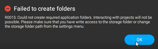

Error message
Failed to create folders, "R0015: Could not create required application folders. Interacting with projects will not be possible..."
0e179a27-a0b8-4d7a-9c98-b3d5c9c7ca60
Solution
  1. Make sure that the user has writing access to the selected folder.
  2. Make sure that the disk is not selected as the final folder. (for example, D:\ or E:\)
    Create a folder inside the disk and select the latter. (for example, D:\PIX4Dfields\)
  3. Make sure that no special characters are used on the path to the folder like middle bars.
  4. Ensure that the storage disk hasn't changed. Sometimes from D:\ to E:\ or vice versa.
