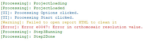

The "Error e0047: Error in orthomosaic resolution value" appears most often when attempting to run processing step 3 in PIX4Dmapper.
e0047

When processing step 2, it is possible that the Ground Sampling Distance (GSD) is not properly written, causing misalignment when starting processing step 3.
Solutions
To solve this problem, we recommended to the user to use the Menu Process > Generate Quality Report tool (more information in this article: Menu Process > Generate Quality Report - PIX4Dmapper)
By regenerating the Quality Report the GSD value will be updated and PIX4Dmapper will be able to process Step 3 without getting the error "e0047: Error in orthomosaic resolution value".
