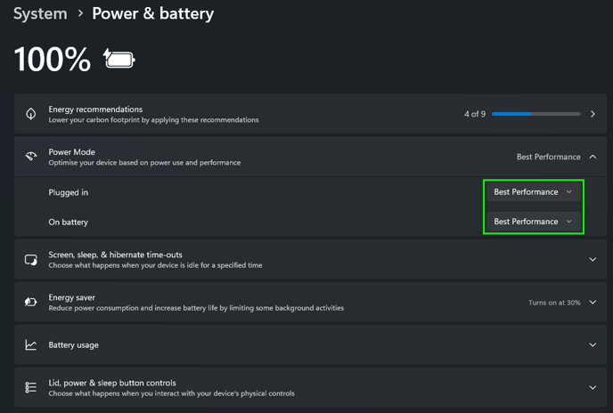

Tip: To use the full CPU in Windows, navigate to System > Power & Battery and set the power mode to Best performance. This power mode can be used both when plugged in and when using the battery.
