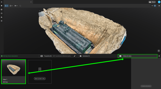

  • Click on the video.png Videos & Views tab in the bottom right corner.
  • Navigate in the 3D view to the desired location.
  • Save the current view by clicking on Save current view or using the Ctrl+B keyboard shortcut.
  • The first view is created and added to the Views list.

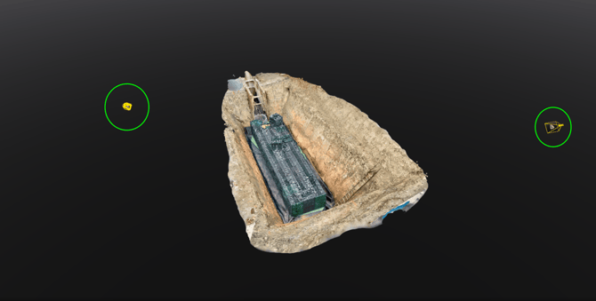

  • A yellow camera will be created in the 3D view, showing the location and orientation of each view.

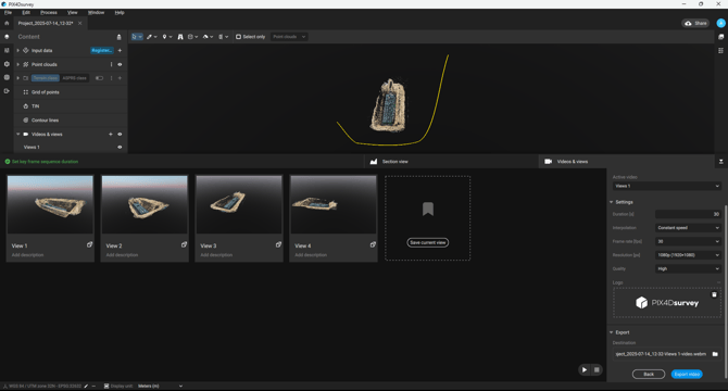

video_survey_1.79-1
Settings
Video animation settings
Duration[s] Sets the duration of the video in seconds.
Interpolation Controls transition smoothness with either Constant speed or Constant time between keyframes.
Frame rate [fps] Adjusts frames per second for motion fluidity.
Resolution [px] Sets video clarity in pixels, in 480p, 720p, 1080p, 2K, or 4K.
Quality Adjusts compression between Very high, High, Medium, Low.
Logo Add a custom logo in the video.
Destination Specifies the video saving or sharing location.
Export
After creating the Views and modifying the video animation settings, click on Export video to export the video animation to the location identified in the Destination setting. The status bar will be updated with the progress of the export. After the export is complete, a .webm file will be created in the desired location for further use.
