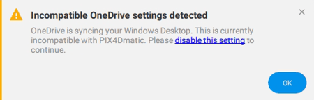

On an earlier version than (excluding) 22H2 of Windows 11, PIX4Dmatic 1.43 version or newer will display this warning:
On 22H2 or newer versions of Windows 11, PIX4Dmatic will function normally.

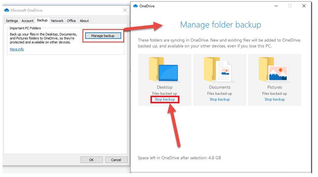

Disable the Microsoft OneDrive “Desktop” Folder automatic synchronization
The issue disappears when syncing with the Desktop folder is disabled.
Solution
  1. Go to the settings of OneDrive
  2. Open the Backup tab
  3. Click Manage backup
  4. On the OneDrive window, click Stop Backup for Desktop Folder (syncing the “Documents” and “Pictures” folders has no impact).
Note: After clicking Stop Backup, the files you currently have on your desktop will disappear. A shortcut called Where are my files will appear on your desktop, guiding you to the current location of your desktop files.
