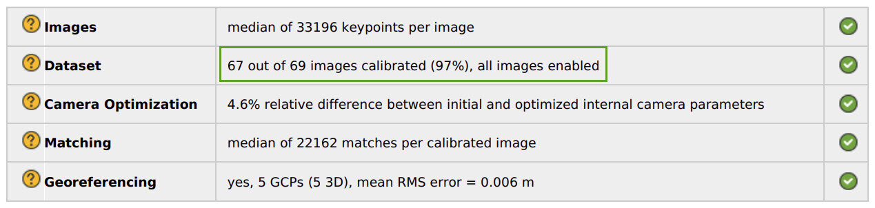

On the Quality Check in the Quality report, it is displayed that there are some uncalibrated cameras after performing step 1 of processing with PIX4Dmapper.
Description
When groups or individual cameras cannot calibrate, this can result in missing areas of the model and areas with lower accuracy.
