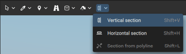

To access the Section view:
  • From the toolbar on 3D view:
    • Vertical section section_vertical-16
    • Horizontal section section_horizontal-16
    • Section from polyline section_polyline-16
    • Section from planar polygon section_polygon-16
  • From the bottom panel, navigate to elevation_profile-16 Section View
  • From the Content Panel on the left side, navigate to dual_mode Sections

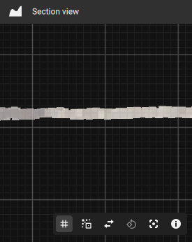

Information: The grid in the section can be used to have an estimation of the scale. There are major and minor lines. The distance between the lines can be seen in the bottom right corner. This value is automatically updated when zooming in or out.
Navigation:
 Captura de pantalla 2025-11-18 143436
  • Use the mouse scroll wheel or pinch zoom on the trackpad to zoom into the section.
    Click and drag with the mouse cursor to pan within the section.
  • To enable the ortho mode, click on Ortho button ortho_mode
  • To snap to the point cloud, click on the Snap button sanp_point_cloud
  • To invert the direction of the section, click on the Invert button swap.
  • To reset the view, click on the Reset view button Reset View Button. This will reset the section view focusing on the profile box.
  • To rotate the section, click on the Rotate section 90° button rotate_90.
  • For more information click on the Info button info-outline.
