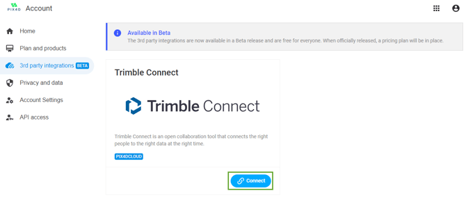

To connect PIX4Dcloud to Trimble Connect:
  1. Log in with PIX4D credentials at cloud.pix4d.com.
  2. In PIX4Dcloud Drive, click the user icon in the top-right corner.
  3. Click Integrations.
  4. Click Connect.
  5. On the Trimble Connect login page, enter the Trimble credentials and sign in.
  6. After successful authentication, the Integrations page confirms the connection to Trimble.
  7. Return to PIX4Dcloud Drive, click the user icon, and verify that the account is connected.

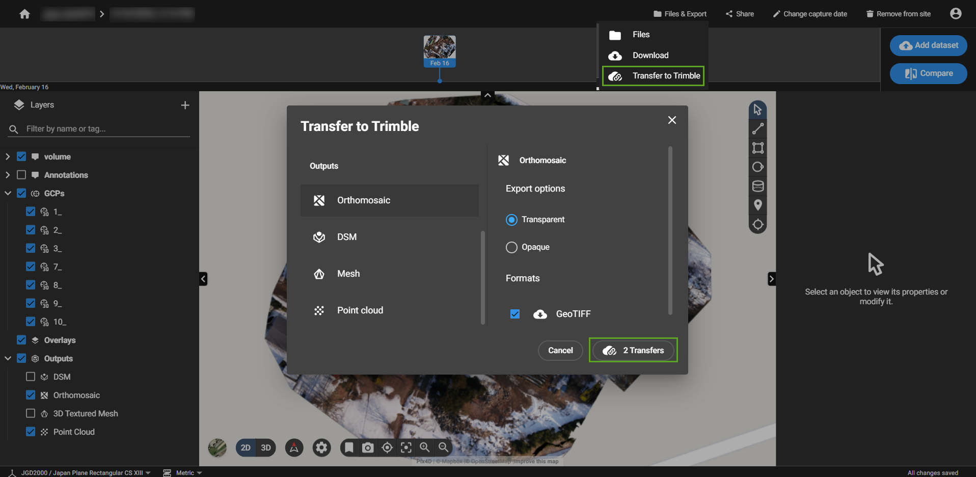

To transfer files from a dataset to Trimble Connect:
  1. Open the desired dataset in PIX4Dcloud.
  2. On the top bar, click Files & Export > Transfer to Trimble.
  3. In the Export dialog, select the files to transfer.
    The number of selected files is displayed.
  4. Click # Transfers, where the number corresponds to the selected outputs.

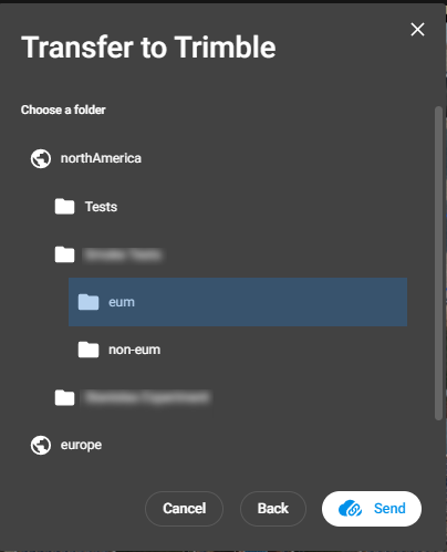

  5. Select the destination in Trimble Connect:
    • Cluster: North America, Europe, or Asia
    • Folder: Select the target folder or subfolder
  6. Click Send to start the transfer.

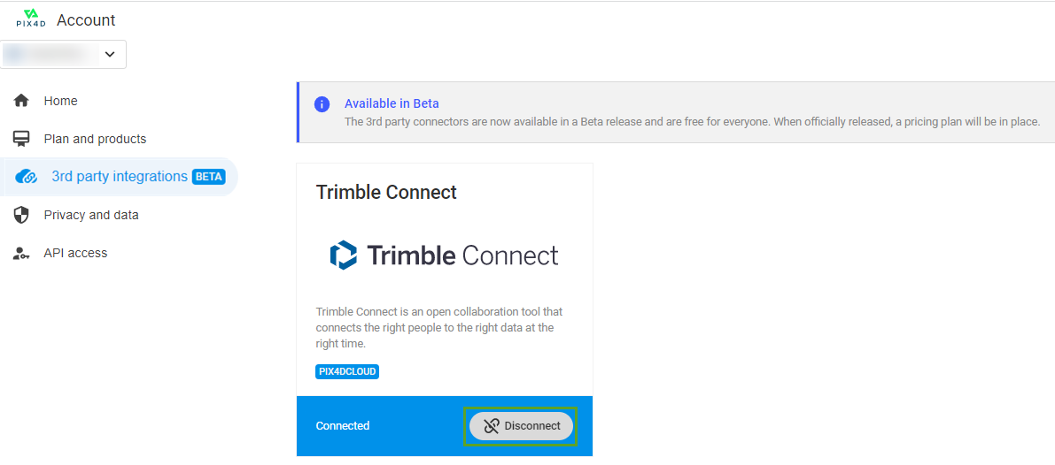

Disconnect from Trimble Connect
To disconnect the Trimble Connect integration:
  1. Log in at cloud.pix4d.com.
  2. In PIX4Dcloud Drive, click the user icon.
  4. Click Disconnect under the Trimble integration.
Note: To connect PIX4Dcloud to a different Trimble account, disconnect the current integration, log in directly to the Trimble Connect website with the new account, and then reconnect the integration from PIX4Dcloud.
