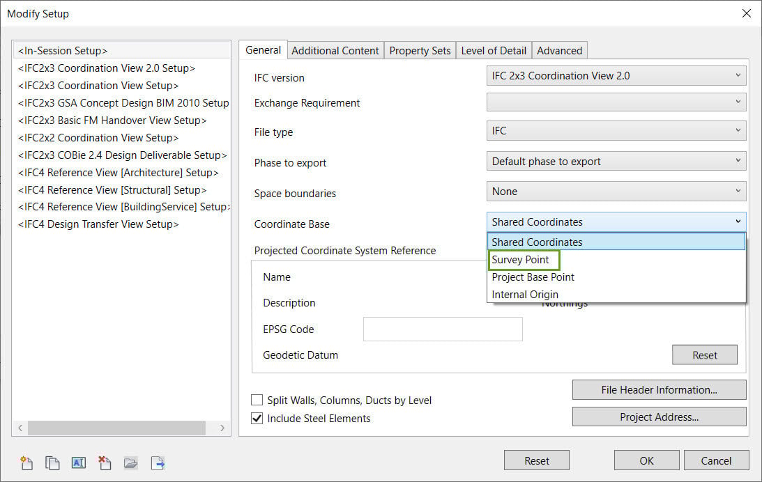

To export the IFC file with the correct coordinate system:
  1. On the menu bar, click File > Export > IFC.
  2. In the Export IFC dialog, click Modify setup….
  3. In the General tab, select Survey Point as the Coordinate Base.
  4. Click OK to confirm and export the file.
