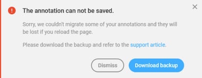

1. Annotation Migration Failure
Due to internal changes in how annotations are stored, existing annotations are automatically migrated to a new database when an older project is opened.
If the migration process fails, the user interface displays:
  • A notification indicating that there was a problem with the migration.
  • A failed status icon next to the annotation layer that could not be migrated.
Selecting the affected annotation layer displays the specific reason for the failure.

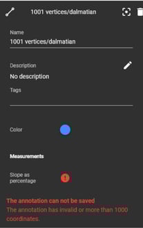

2. Unsupported Annotation Format During Import
When importing annotations into the annotation hierarchy, some files may not meet the supported format requirements. In this case:
  • The annotation is not imported.
  • A failed status icon appears under the annotation layer hierarchy.
  • Selecting the layer displays the exact reason for the failure.

  • Click Download backup to export the affected annotations in GeoJSON format.
  • If the file is large or complex, split it into smaller files with fewer coordinates.
  • Re-import the corrected files into the project.
For Import Failures
  • Verify that the annotation file format is supported by PIX4Dcloud.
  • Check the error message displayed when selecting the failed annotation layer.
  • Correct the file structure or geometry as indicated and re-import the annotation.
Warning: Clicking Dismiss or refreshing the page removes the failed status icon. Any annotations that were not successfully migrated will be permanently lost if no backup is downloaded.
