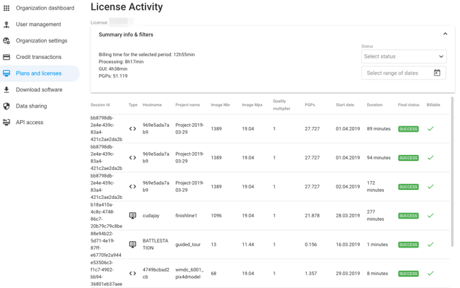

The activity list contains the details of the projects processed through a PIX4Dcloud Enterprise license with API access. This includes, for example, the number of projects, the project size, time per project, processed gigapixels (PGP), etc.

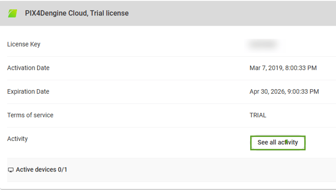

5. Under the License tab, search for the PIX4Dengine Cloud API  (for legacy licenses) or PIX4Dcloud Enterprise.
6. Click See all activity.

7. (Optional) It is possible to filter the processing activity list by:
  • Status: Success, Failure, Cancelled, or Crash
  • Month
  • Year
Example: If Status: Success, Month: 1, and Year 2022 are selected, then the activity list will display all the successful projects of January 2022.
