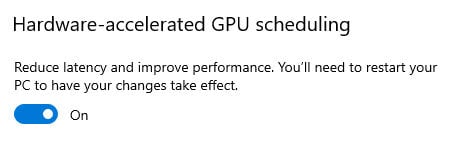

  • Make sure that Hardware-accelerated GPU scheduling is set to On
HW accelerated win10
  • A restart may be required if the Hardware-accelerated GPU scheduling was just enabled

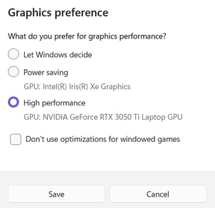

  • Click on the newly added PIX4Dsurvey and then click on Options and then select High performance
2024-06-27_12-20-24
2024-06-27_12-20-24
Click Save. Click Save.
PIX4Dsurvey is now listed as using the High-performance preference.  PIX4Dsurvey is now listed as using the High-performance preference.
