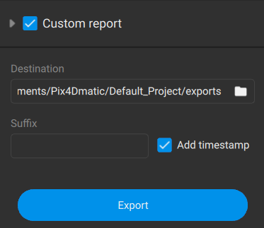

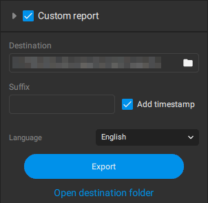

Export
After selecting the desired options, click on Export to export the Custom report to the location identified in the Destination setting. Additionally, it is possible to select the language (English, Spanish, French, Chinese Simplified, Japanese, Korean, Chinese Traditional, German, Portuguese, Turkish, Czech, and Ukrainian).
The status bar will be updated with the progress of the export. After the export is complete, a .pdf file will be created in the desired location for further use.
 custom_report_2.1
