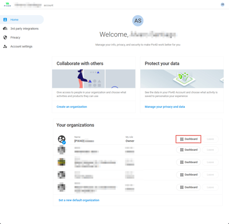

- Open your account page and log in with your Pix4D account.

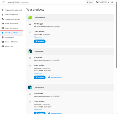

- Under Your Organizations, select the Dashboard of your organization holding the license(s)
- On the left sidebar, select Download software.

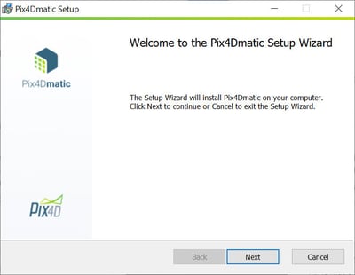

1. Double-click the downloaded file. The PIX4Dmatic Setup wizard starts.
2. (optional) If the pop-up Open file - Security Warning appears, click Run.
3. In the pop-up PIX4Dmatic Setup, in the screen Welcome to the PIX4Dmatic Setup Wizard, click Next.

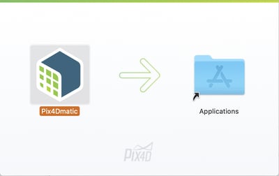

2. Drag and drop the PIX4Dmatic logo into Applications.
