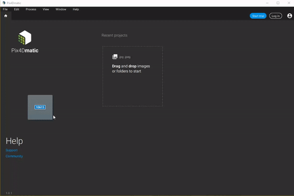

New projects in PIX4Dmatic can be created by dragging and dropping images or image folders on the home screen, using the menu bar, or the Ctrl + N (⌘ + N) shortcut.
Drag and drop input files
  1. Drag and drop images or image folders on the home screen.
  2. Specify the Project name and the Path of the project.
  3. Click Start.

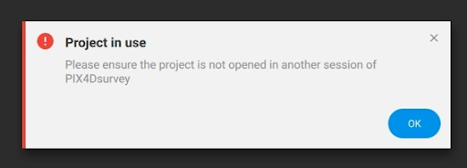

In some cases, the software may display a “Project in use” message even when the project is not open elsewhere. In such cases, you can remove the project.lock file located in the temp subdirectory of the project folder
project_use
Important: The project must be closed before deleting the file.
