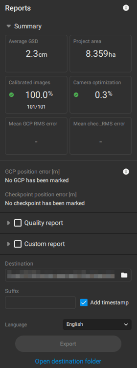

PIX4Dmatic generates a quality report that can be used to get an overview of the project and assess its accuracy and quality.
The following is available:
  • A General report is generated after running the Calibrate or Reoptimize step:
    • Click the Report Pix4Dmatic report panel.png panel.
      QR_2,2
  • Detailed quality report (.pdf). To export the detailed quality report:
    • In the Report panel, Check the Quality Report checkbox, then click Export.
    • In the Processing options panel, check Exports - Quality report.
    • On the Menu bar > File, click Export quality report...
