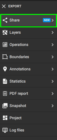

  3. Click the EXPORT button at the top right corner of the dashboard.
  4. Click Share:
    Share_
  5. Click John Deere Operations Center.

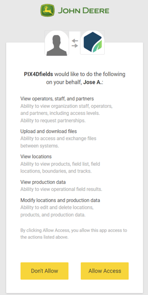

  8. Enter valid credentials.
  9. Click Allow Access
    allow access

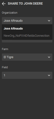

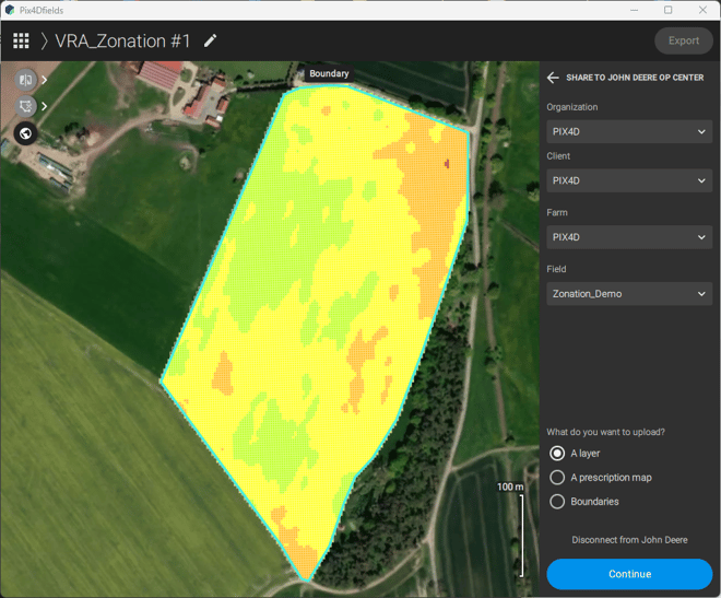

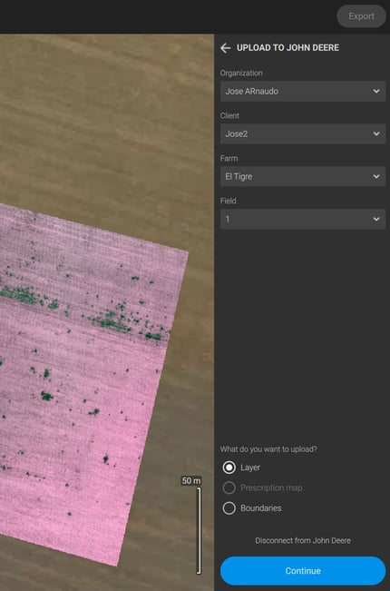

11. Select the Organization, Client, Farm, and Field specified in the John Deere Operation Center.
image-20260528-123813
12. Select the layers to be uploaded and click Continue.
Warning: To upload layers to John Deere Operations Center, it is important to have an Organization, Client, Farm, and Field. You can create a Field on the Operation Center Map, here.
Warning: When an organization is created, the organization owner can add users and should set the access level for the people in that organization. Verify that you have all the permissions such as the right to create a map layer summary in an organization

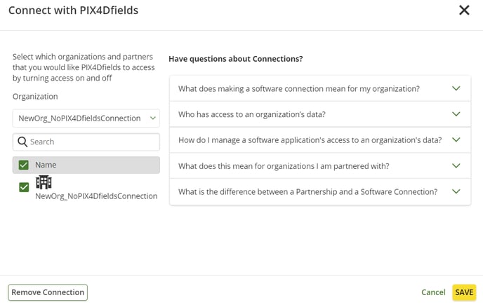

  • If client, farm and field are not shown, go to the Operation Center Connections >> Find PIX4Dfields >> Click Connect>> Click Allow access.
  • The organization is visible, but can't select it as it is greyed out.
    • In this case, the greyed Organization does not have permissions:
    • Please visit Connect to PIX4Dfields and select the organization and partners that need access to PIX4fields.

When sharing, it is possible to upload one at a time, selecting between:
  • A layer:
    • This option allows uploading Orthomosaic, Digital Surface Model, and Index maps.
    • It is possible to change the name and add a description.
  • A prescription map:
    • This option allows uploading all types of Targeted Operations maps.
Using Targeted operation map

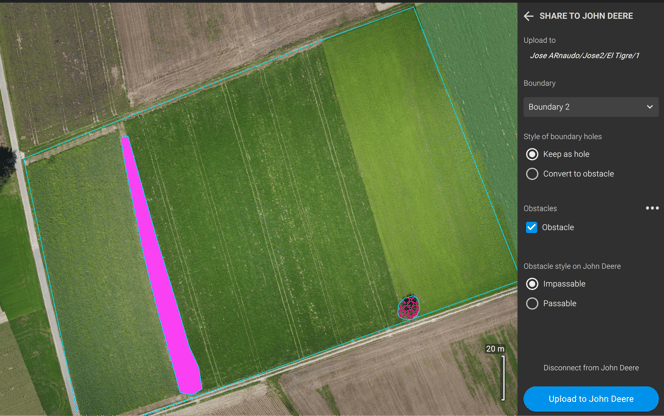

  • Boundaries:
    • This option allows uploading boundaries, possibly converting holes to Obstables if needed and setting the Obstacles as Impassable or Passable.boundaries menu
    • Click Upload to John Deere, after a few minutes, the layer is available on the platform.
Warning: Sharing boundaries with sub-polygons or holes is only possible since PIX4Dfields 2.8. Using previous versions can cause the upload to fail.

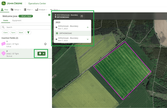

The layers that have been uploaded through PIX4Dfields will be displayed Map display.
In order to see the layers:
  • Click the Fields tab to see the fields.
  • Select a field and click the layers icon.
  • Select the available layers in the timeline:

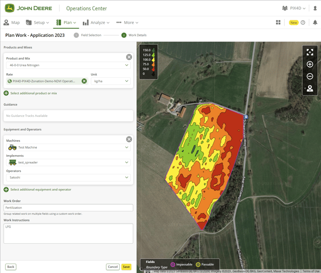

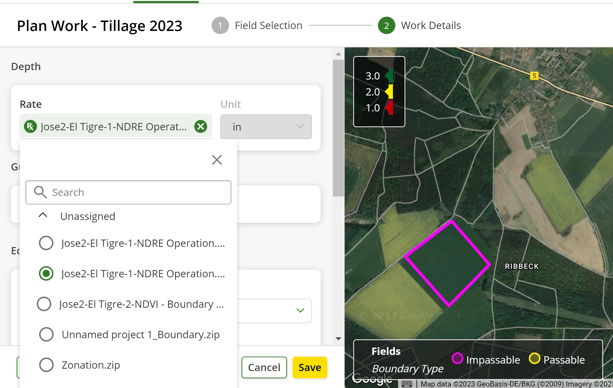

To plan a variable rate application using a Targeted Operations map:
  • go to Plan, Work Planner.
  • Select the field.
  • Go to Rate and select the map
variable rate map
