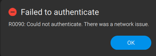

R0087: "Failed to log in. Could not authenticate. There was a network issue."
R0090: "Failed to authenticate. Could not authenticate. There was a network issue."
Description
- Error when logging in PIX4Dfields.
- Error when starting a trial period.
- Error when trying to download satellite images.
Cause
There is a proxy/antivirus/firewall on the PC that does not allow the application to validate the HTTPS certificate chain. As a result, communication with the PIX4D server is impossible.
