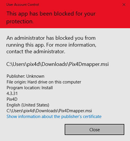

Error
"This app has been blocked for your protection".
Windows warning
Description
This is a warning that may show up when installing PIX4Dmapper on Windows 10.
The company that issued the certificate used for signing the MSI installation files of PIX4Dmapper declared bankruptcy a few days ago.
This means that if your version of Windows is up to date, Microsoft puts this certificate issuer on a blacklist, and therefore the signed software could not be installed or uninstalled.
Information: This is only a warning and does not present an actual threat when using the software. Keep in mind that we recommend using the official installation files downloaded from the Pix4D download page.

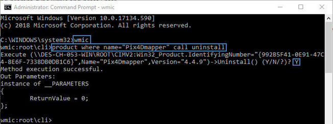

(Optional) It is possible to uninstall the software using administrator rights:
  • Open the Start Menu on Windows.
  • Search for Command Prompt.
  • Right click on the Command Prompt icon in the Start Menu.
  • Select Run as administrator.
  • Type wmic and press Enter.
  • (PIX4Dmapper) Type product where name="PIX4Dmapper" call uninstall and press Enter.
  • (PIX4Dfields) Type product where name="PIX4Dfields" call uninstall and press Enter.
  • If prompted, type Y to confirm uninstalling the program, and press Enter.
