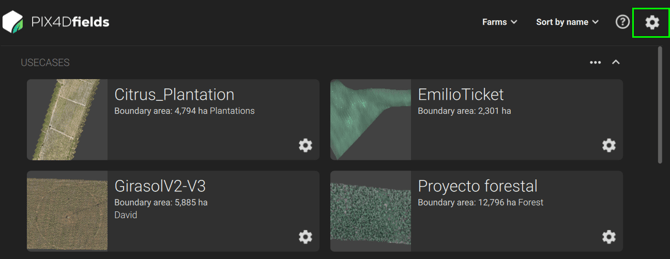

To access it:
1- Go to Settings on the top-right:
AccessHomeSettings
2-
 Click on the Data storage folder:

  1. Click the Settings icon at the top-right of the home screen.
    AccessHomeSettings

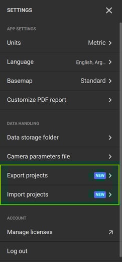

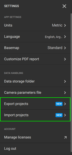

  2. Click Export projects
    ExportImport_BatchProcess

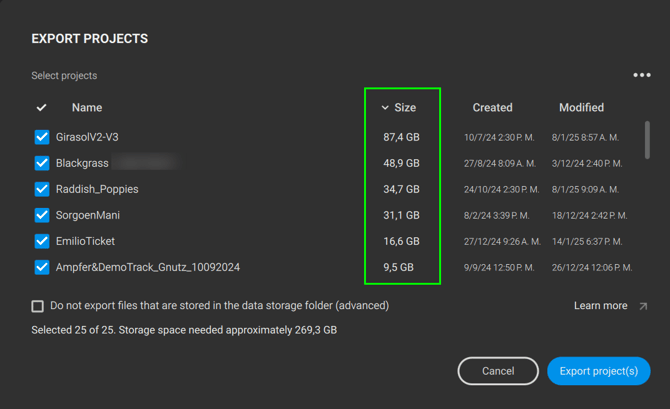

  3. The Export projects menu appears.
  4. All projects will be selected by default.
    1. Order projects by clicking on the column name. You can order by Name, Size, or Created/Modified dates.
      Ordering by Size is recommended to know which projects occupy the most space.
      ExportMenu_WithSizeOrder
    2. The option "Do not export files that are stored in the data storage folder (advanced)" should be enabled only when exporting the project structure without including the files from the Data storage folder. This setting is intended for scenarios where the Data folder will be manually transferred to the desired location.
  5. Click Export project(s).
    1. Ensure sufficient disk space before exporting, otherwise Error 0175 will occur.
      “Unable to detect sufficient disk space.
       R0175: Caution, the selected folder may not have sufficient disk space, projects may fail to export correctly”

  1. Click the Settings icon at the top-right of the home screen.AccessHomeSettings
  2. Click Import projects
  3. Select one or multiple .p4z files to import.
  4. Click Open.

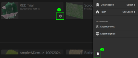

Delete a PIX4Dfields project
To delete PIX4Dfields projects:
  1. Go to the Dashboard.
  2. Click on the project settings.
  3. Click the Delete icon at the bottom.
