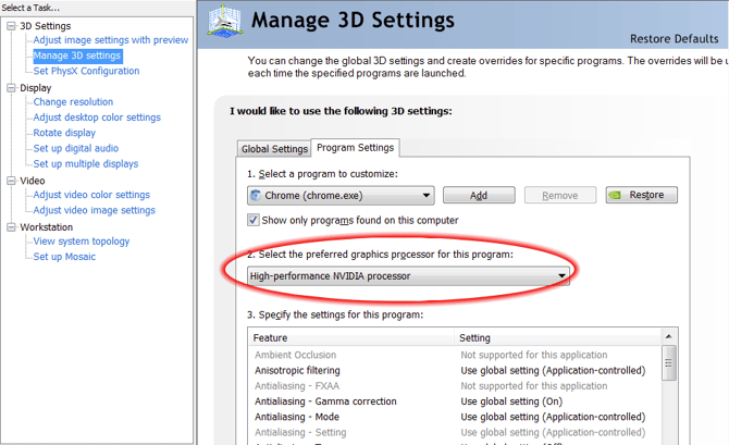

Configure NVIDIA GPU Settings
To force the browser to use the high-performance NVIDIA GPU:
  1. Ensure the latest NVIDIA GPU driver is installed (version 337.19 or newer).
    For more information, see: How to update the NVIDIA graphic card.
  2. Open the NVIDIA Control Panel (see: How to reach the NVIDIA admin panel).
  3. In the left panel, select 3D Settings > Manage 3D settings.
  4. Open the Program Settings tab.
  5. Under Select a program to customize, choose the web browser used to access PIX4Dcloud.
  6. Under Select the preferred graphics processor for this program, choose High-performance NVIDIA processor.
  7. Apply the changes and restart the web browser.
