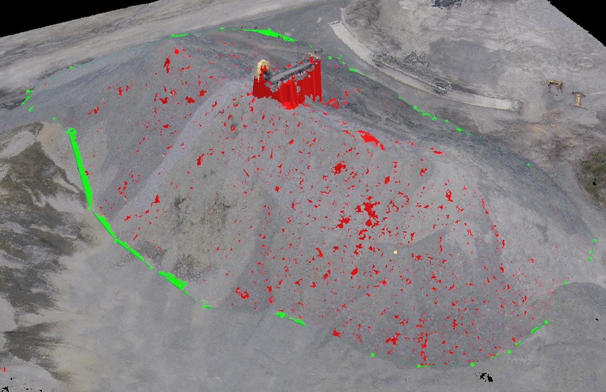

Volume with an object on the stockpile

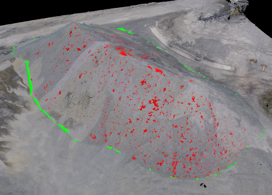

Volume after removing the object from the stockpile
