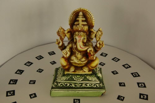

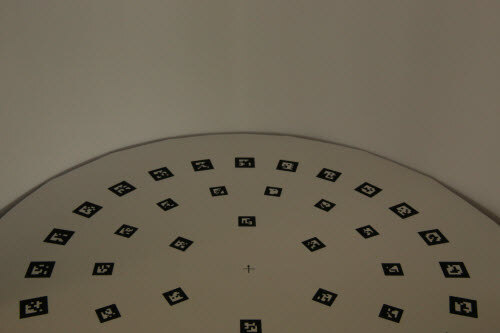

1. Orient the turntable so that the small arrow in the center of the turntable points away from the camera, as in the image below.
Information: This arrow gives the direction of the y-axis of the local coordinate system and will allow the model to be reconstructed facing towards the viewer.
2. Place the object on the turntable.
3. Capture the first image.

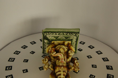

6. Turn the object and place it on the turntable again.
7. Repeat steps 1 to 6 to capture a second dataset from another point of view to fully reconstruct the object. Capture as many datasets as needed to capture the object completely.

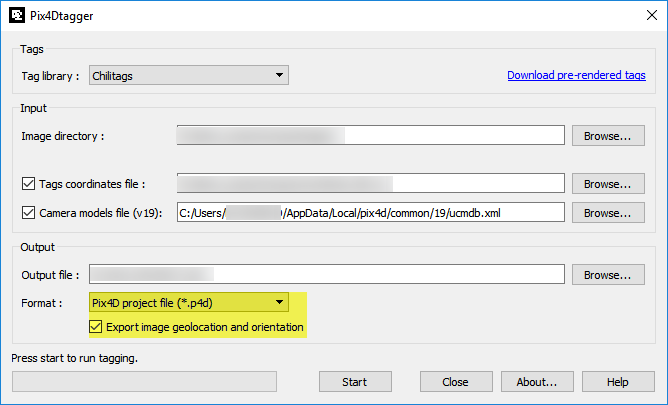

Using the PIX4Dtagger to generate the .p4d project file
1. Open the PIX4Dtagger. PIX4Dtagger has been installed with PIX4Dmapper from version 2.2 up to 4.5.6. The PIX4Dmapper 4.5.6 installation file is available to download here. The executable is located in the same folder as your PIX4Dmapper executable (PIX4Dmapper.exe). Therefore, its location will depend on where you installed PIX4Dmapper. For example, this could be: C:\Program Files\Pix4Dmapper
2. In Image directory, click Browse... and select the directory where the images are stored. Use PIX4Dtagger for one subproject at a time.
3. In Tags coordinates file, click Browse... and select the *.csv file in which the tags that were used in the project and their corners are stored. The file can be downloaded from here.
Important: The coordinates of the visual markers are computed for a turntable where the big markers measure 1.6X1.6 cm and the small markers measure 1.2X1.2 cm. If the printed markers are of different dimensions, the object will be modeled without a real scale. In that case, a scale constraint can be added after Step1 has been processed: How to scale a project
4. In the Camera models file, click Browse...  and select the camera database in: C:\Users\Your Username\ AppData\Local\pix4d\common.
Important: In case the camera is not included in the PIX4D camera data base, it should be saved into it when creating the project: Menu Project > Image Properties Editor... > Selected Camera Model > Edit Camera Model
5. In Output file, click Browse... and select the name of the output file and where it should be stored.
6. In Format, select PIX4D project file (*.p4d) and make sure that Export image geolocation and orientation is selected. PIX4Dtagger is able to compute exterior orientations based on the tag´s coordinates. These exterior orientations will be used as initial values during the standard PIX4D process and they will help in the reconstruction.
7. Click Start to start exporting the project file.
8. Repeat steps 1-7 for each dataset captured.
9. Click Close to close PIX4Dtagger.

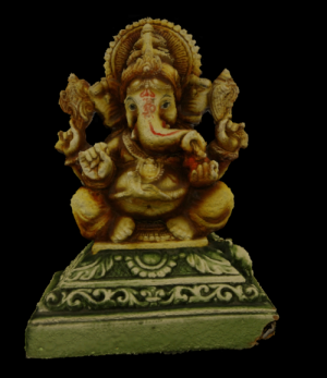

6. Process step 2. Point Cloud and Mesh for the merged project.
7. (optional) Edit the point cloud to remove the points of the visual marks reconstructed, following: How to edit the point cloud in the rayCloud.
8. (optional) Regenerate the 3D Textured Mesh without the visual marks, following: How to generate the 3D Textured Mesh (section: After processing step 2. Point Cloud and Mesh).
