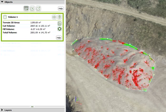

In PIX4Dmapper the Volume menu provides more information regarding Volumes as well as the option for the user to manually edit them in a project.
Access: On the Menu bar, click View > Volumes, and then click Volumes.
The following options are displayed:
New Volume
A Volume is an object that can be used for volume calculations. It is defined by a 3D Surface called a base surface. The volume is computed between the base surface and the terrain surface, defined by the DSM.
For step-by-step instructions about how to draw a new volume: How to draw a Volume.
Once a New Volume is created, the Sidebar displays the following information: Menu View > Volumes > Sidebar > Objects.
