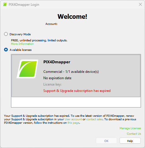

How to log out of PIX4Dmapper if you are using a version that you are not allowed to use because of an expired Maintenance Plan:
  1. If you are logged in with an account with an OTC license with an expired Maintenance Plan, at login, you will see a pop-up (image below), and you will be asked to select the Discovery Mode or select an available license. When the license with expired S&U is selected, it is not possible to select OK.
    OTC with expired S&U and too recent version of PIX4Dmapper

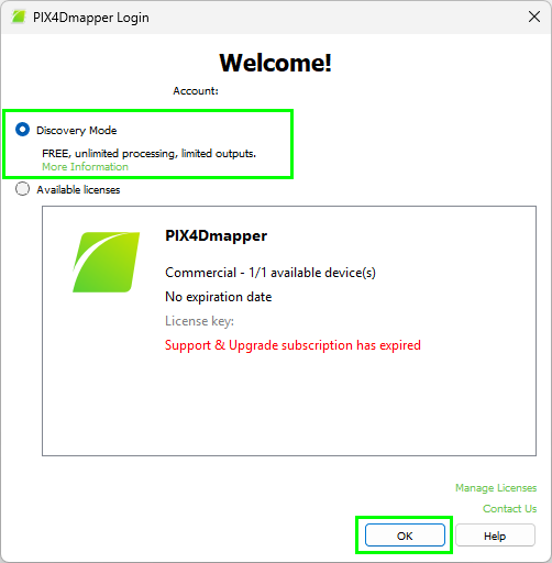

  2. Select Discovery Mode and then click on OK.
    Select discovery mode
