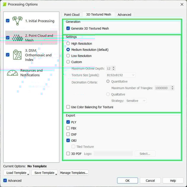

Access: On the Menu bar, click Process > Processing Options..., the Processing Options pop-up appears. Click 2. Point Cloud and Mesh. By default, only the Point Cloud and the 3D Textured Mesh tabs appear. On the bottom left, select the Advanced box to display other tabs.
3D Textured Mesh
Allows the user to change the processing options and desired outputs for the 3D Textured Mesh of step 2. Point Cloud and Mesh. This tab contains 3 sections:
  • Generation: Allows the user to select the generation of the 3D Textured Mesh.
  • Settings: Allows the user to select parameters concerning the generation of the 3D Textured Mesh.
  • Export: Allows the user to select the desired output formats for the 3D Textured Mesh.
Generation
  • Generate 3D Textured Mesh: Allows the user to select whether the 3D Textured Mesh should be generated.
Settings
Allows the user to select the resolution for the 3D Textured Mesh generation.
  • The Point Cloud is used to generate a surface composed of triangles. The distance between the mesh and the points of the Point Cloud is optimized to be minimal, but this means that points of the mesh do not necessarily correspond to points of the point cloud.
  • Since the mesh is 3D, it is unfolded onto a 2D plane in order to define the resolution (pixel size). Then the 3D position of the pixel is reprojected into the original images to obtain the color. Blending is used instead of stitching to generate the texture of the 3D Textured Mesh.
  • The 3D Textured Mesh will be generated using the Point Cloud. If a Processing Area and/or Image Annotations are defined, and if the corresponding options are selected in the Point Cloud Filters options, they will also be used for the generation of the 3D Textured Mesh.
The available parameters are:
  • High Resolution: High level of detail. Recommended to maximize the visual aspect of the 3D Textured Mesh. Computing time and size will increase significantly.
  • Medium Resolution (default): Default option. Recommended setting for most project. Strikes a good balance between size, computing time and level of detail for the 3D Textured Mesh.
  • Low Resolution: Lower level of detail leading to faster computing time and lower size. Good compromise for sharing the 3DTextured Mesh.
  • Custom: Allows the user to select the options for the 3D Textured Mesh generation:
    • Maximum Octree Depth: To create the 3D Textured Mesh, the project is iteratively subdivided into 8 subregions. These are organized in a tree structure, and this parameter indicates how many subdivisions should be created. Higher values mean that more regions will be created, hence each region will be small, leading to higher resolution and higher computing times.
    • Texture Size [pixels]: Parameter used to define the resolution of the texture of the 3D Textured Mesh, affecting the pixel size.
    • Decimation Criteria: After the first step in the mesh creation, too many triangles are created and this parameter indicates how the spurious triangles should be discarded.
      • Quantitative: Some triangles will be discarded till they reach the desired number:
        • Maximum Number of Triangles: Maximum number of triangles in the final 3D Textured Mesh. The number will depend on the geometry and the size of the project.
      • Qualitative: Some triangles will be discarded trying to maintain the original geometry.
        • Strategy: Indicates the strategy employed to discard the triangles:
          • Sensitive: The triangles selected have as priority to maintain the original geometry of the 3D Textured Mesh.
          • Aggressive: The triangles selected have as priority to maintain a lower number of triangles.
    • Use Color Balancing for Texture: The Color Balancing algorithm will be used for the generation of the texture of the 3D Texture Mesh. The Color Balancing algorithm ensures that the texture will be homogeneous.
Note: For projects that are not very large, it may be that the resulting number of triangles is lower than the maximum set up in the options. The maximum will only be reached if the project is large and could create a model with more triangles.
Important: The higher the parameters selected the longer the processing time. Using high definition parameters have more visual impact when zooming in and visualizing the model from close. This allows to better identify details in the model.
For step by step instructions about how to generate the 3D Textured Mesh: How to generate the 3D Textured Mesh.
Export
The following formats can be chosen:
Note: It is possible to select more than one format in order to save the 3D Textured Mesh in multiple formats. When no output is selected, only a .p4b file is generated. It is always generated but can only be opened in the rayCloud of PIX4Dmapper.
