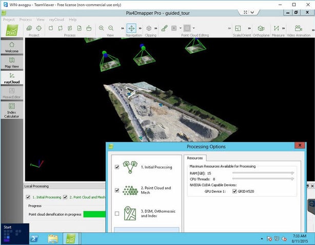

CUDA Processing & Visualizing (GPU instances)
There are currently two GPU instances: g2.2xlarge and g2.8xlarge. The first one has limited CPU power and is not recommended for heavy processing, only for visualization. The second one is nearly as powerful as the fastest compute instance, but is also twice as expensive. The first one can be 2-4 times slower than the second one for most projects.
Instructions to run:
1. Create a GPU EC2 instance, similarly to the instructions above. The instance type must have a GPU.
2. Connect to this instance through the Remote Desktop Protocol.
3. Install TeamViewer and configure unattended access according to the instructions found here.
4. Install the NVIDIA drivers for the GPU. The model is GRID K520 and the drivers can be found here.
5. Reboot the server. You can now login through Teamviewer instead of RDP.
6. In the Windows Device Manager, disable and uninstall the default entries for the Display adapters. The associated files must be forcefully removed by running the following commands in the Windows Powershell:takeown /f C:\Windows\System32\Drivers\BasicDisplay.sys
echo Y | cacls C:\Windows\System32\Drivers\BasicDisplay.sys /G Administrator:F
del C:\Windows\System32\Drivers\BasicDisplay.sys
Then:
1. Reboot the server.
2. Login to the server using Teamviewer.
3. (Optional) Open Pix4Dmapper and visualize the rayCloud.
