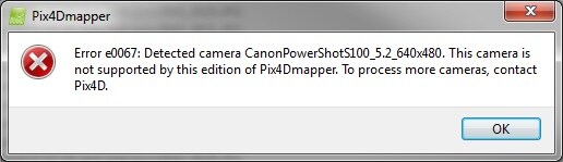

Error e0067: "Detected camera name_focal_resolution. This camera is not supported by this edition of PIX4Dmapper. To process more cameras, contact Pix4D."
Error
Description
When importing images in PIX4Dmapper, the following error message appears:
