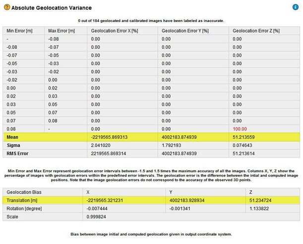

9. On the Menu bar, click Process > Quality Report... to open the Quality Report. At this stage of processing, the Geolocation Bias Translation corresponds to the mean Absolute Geolocation Error, which is usually large.

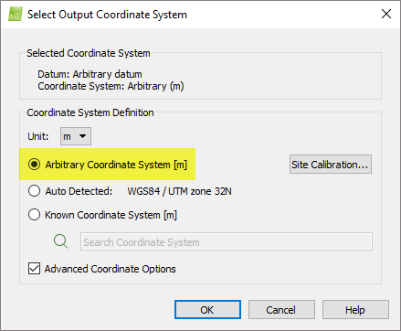

10. On the Menu bar, click Project > Select Output Coordinate System.
11. On the pop-up Select Output Coordinate System, under Coordinate System Definition, select Arbitrary Coordinate System.
12. On the pop-up Select Output Coordinate System, under Coordinate System Definition, select the checkbox Advanced Coordinate Options.

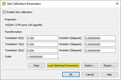

13. On the pop-up Select Output Coordinate System, in Arbitrary Coordinate System, click Site Calibration... The pop-up Site Calibration Parameters appears. It displays the transformation between the image and the GCP/output coordinate system as well as the coordinate systems between which the transformation is defined. Select the box Enable Site Calibration.
14. On the pop-up Site Calibration Parameters, click Load Optimized Parameters to load the transformation parameters estimated during processing.

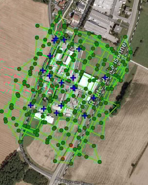

16.1 From the menu bar, click View > Map View to display the Map View. Verify that the GCPs are displayed and located at the correct position.

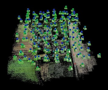

16.2 On the Menu bar, click View > rayCloud to display the rayCloud. In the 3D View, verify that the initial image position is displayed (blue dot) and that it is close to the image computed position (green dot).

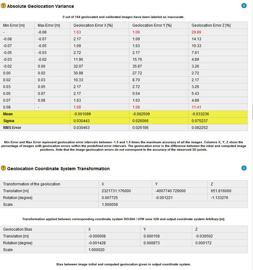

20. Verify that the transformation is good enough. In the Menu bar, click Process > Quality Report... to open the Quality Report. Check the table Absolute Geolocation Variance. The mean of the Geolocation Error in X,Y,Z should be close to 0 and the variance should be small. The Geolocation Coordinate System Transformation table displays the transformation as well as the geolocation bias.

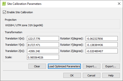

23. On the pop-up Site Calibration Parameters, click Load Optimized Parameters to load the transformation estimated during processing. This transformation takes into account the transformation and geolocation bias displayed in the Quality Report.
24. On the pop-up Site Calibration Parameters, click Export... to export the transformation parameters to a file.
