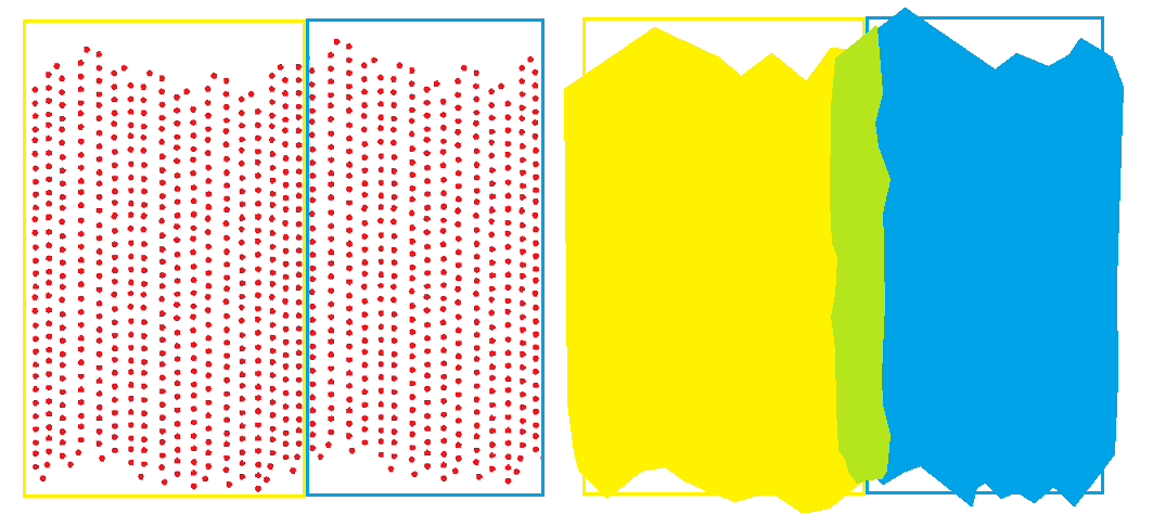

Estimate the distance between the flight lines. It is recommended to divide the dataset into flight lines with the smallest distance between them to maximize the overlap between the subprojects.
Example:
The yellow area is the area covered by the left subproject. The blue area is the area covered by the right sidebar.
The green area is the common area between the two subprojects.
