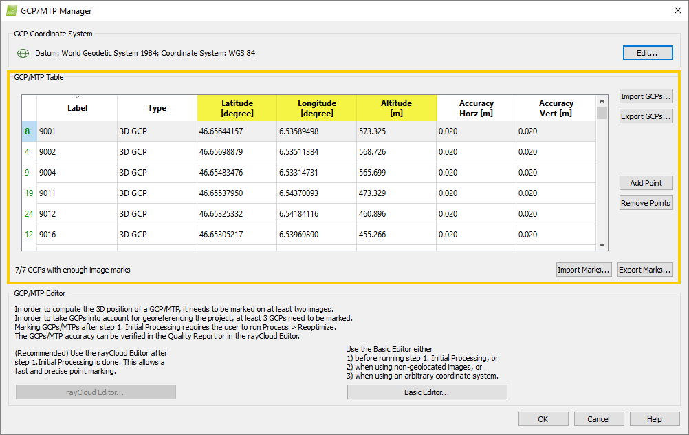

1. Click Project > GCP/MTP Manager...
2. In the GCP/MTP Manager, under the section GCP/MTP Table, verify that the X,Y,Z (or Latitude, Longitude, Altitude) is correct for each GCP.

3. If the coordinates are not correct, correct them manually (How to import and mark ground control points (GCPs)) or import them again from a file (How to import and mark ground control points (GCPs)). If you import the coordinates from a file, verify that the coordinates in the file are correct and that the correct coordinate format (X, Y, Z / Y, X, Z / etc.) is selected when importing the file.
4. On the GCP/MTP Manager, click OK.
