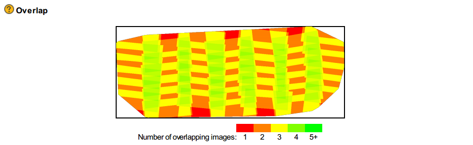

  • Green, orange and yellow patches in the Overlap map in the Quality Report.

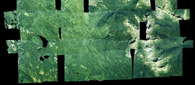

  • Black holes (black rectangles or sharp triangles) in the model where no data is generated.
Figure 1. Quality Report
Figure 2. Point Cloud with black rectangles

  • Black holes (black rectangles or sharp triangles) in the point clouds.

This issue appears if there is not enough frontal and/or side overlap.
Even if there are enough keypoints found on each image, there might be some areas that can only be seen in 2 images.
The Densified point cloud is generated using the Automatic Tie Points and, by default, only contains keypoints that can be identified in at least 3 images. All outputs depending on the Densified point cloud will be affected.
