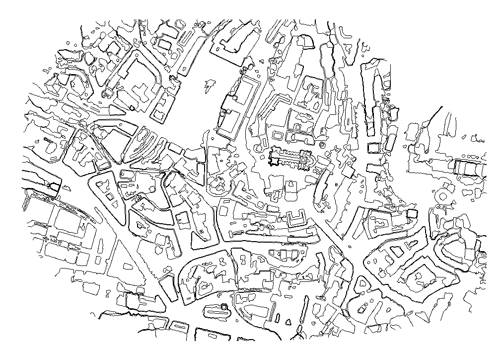

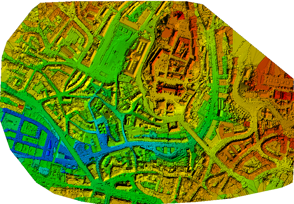

Generated with the digital surface model
Generating contour lines with the digital surface model (DSM) is recommended when there are no objects on the project's surface, such as high vegetation or buildings.
You can achieve a high level of detail in the contour lines because the DSM can have a resolution as high as the average ground sampling distance (GSD) of the project.

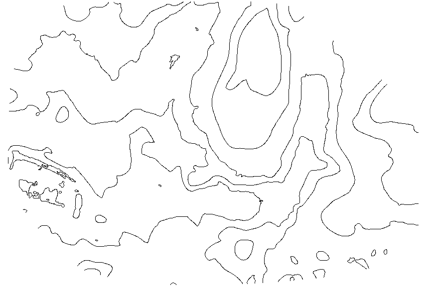

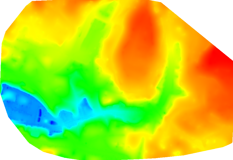

Generated with the digital terrain model
Generating contour lines with the digital surface model (DTM) is recommended when there are objects on the project's surface, such as high vegetation or buildings.
You can achieve a moderate level of detail in the contour lines because the DTM can have a resolution as high as five times the average ground sampling distance (GSD) of the project.
