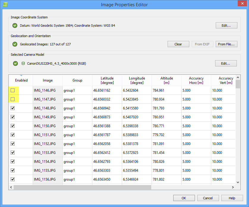

In these cases, to remove the images:
1. Open the project.
2. On the Menu bar, click Project > Image Properties Editor.
3. In the Image Properties Editor pop-up, disable the image by clicking on the check mark under Enabled for the images that are to be removed, as shown below:
4. Click OK.
5. Start step 1. Initial Processing.
  Important: Disabling an image after a processing step is complete has no impact on the project results except if it is
  reoptimized afterward. It is better to disable images before processing.
