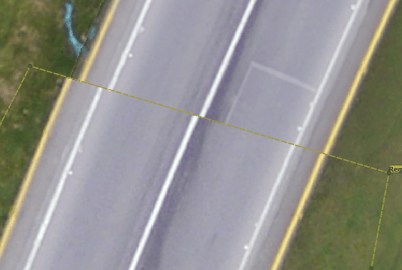

To improve the results of the mosaic with the Mosaic Editor:
1. On the Menu bar, click View > Mosaic Editor (available only if step 3. DSM, Orthomosaic and Index has been completed).
2. On the Mosaic Editing sidebar, under the section Regions click Draw.
3. Left-click to start drawing the region that will be improved (around the bridge).
4. Move the mouse to the next vertex of the region and right-click to add the last vertex.
Tip: Create one region for the entire bridge to avoid the misalignment that may occur at the borders of the different regions. This will give good results only if the entire bridge appears in at least one of the planar images/projections.
5. On the Mosaic Editing sidebar, under the section Images, select the Planar Projection check box (selected by default).
6. On the Mosaic Editing sidebar, under the section Images, select the image / projection that corrects better the bridge's distortions.
