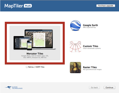

2. Choose Mercator Tiles.

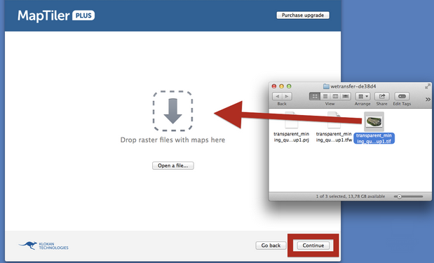

3. Drag & drop the Pix4Dmapper orthomosaic.

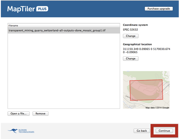

4. Confirm the coordinate system and geographical position by clicking on Continue.

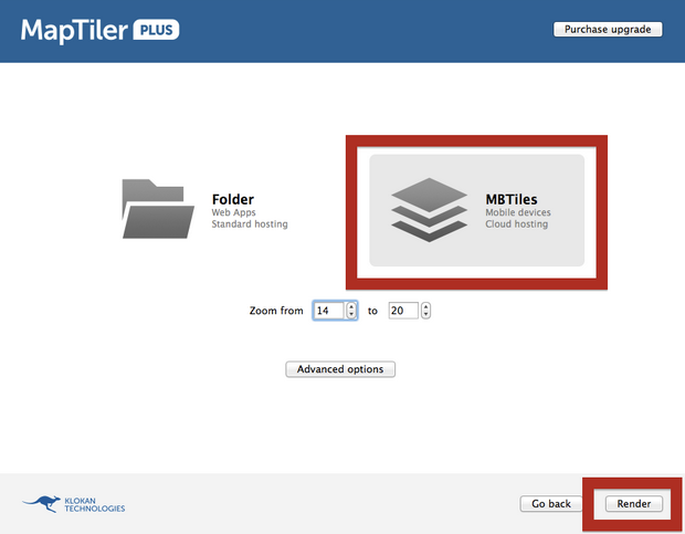

5. Click MBTiles.

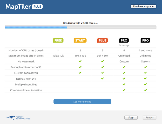

6. Click Render.
7. Select the path where the .mbtiles will be saved.

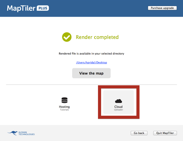

8. Wait until the map is rendered.

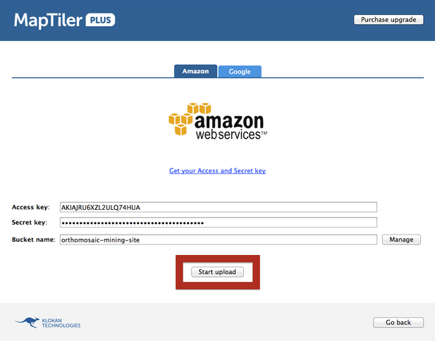

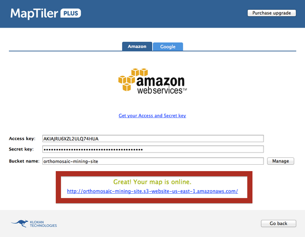

9. Click the Cloud Uploader.
10. Type the Amazon S3 credentials and click Start upload.

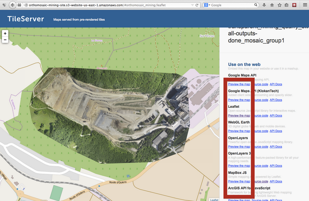

11. Click the link to get on the website with the map.
12. It is possible to preview the map in various Map API’s.
