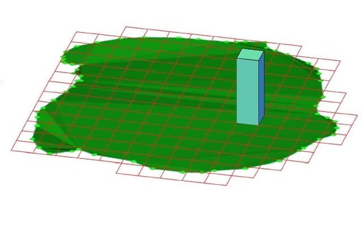

The error for one cell of the volume is given by:
error in X direction (length) = 0 cm.
error in Y direction (width) = 0 cm.
error in Z direction (height) = 1.5*GSD.

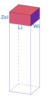

The volume error for each cell is given by:
Ei = Li * Wi * Zei = GSD * GSD * 1.5*GSD = 1.5 * GSD3
Where:
Ei = the volume error of one cell.
Li = the length of the cell.
Wi = the width of the cell.
Zei = the error in the Z direction of the cell.

The volume of one cell:
Vi = Li * Wi * Hi = 503 = 125 000 cm3
and the volume error for this cell:
Ei = Li * Wi * Zei = 187 500 cm3
