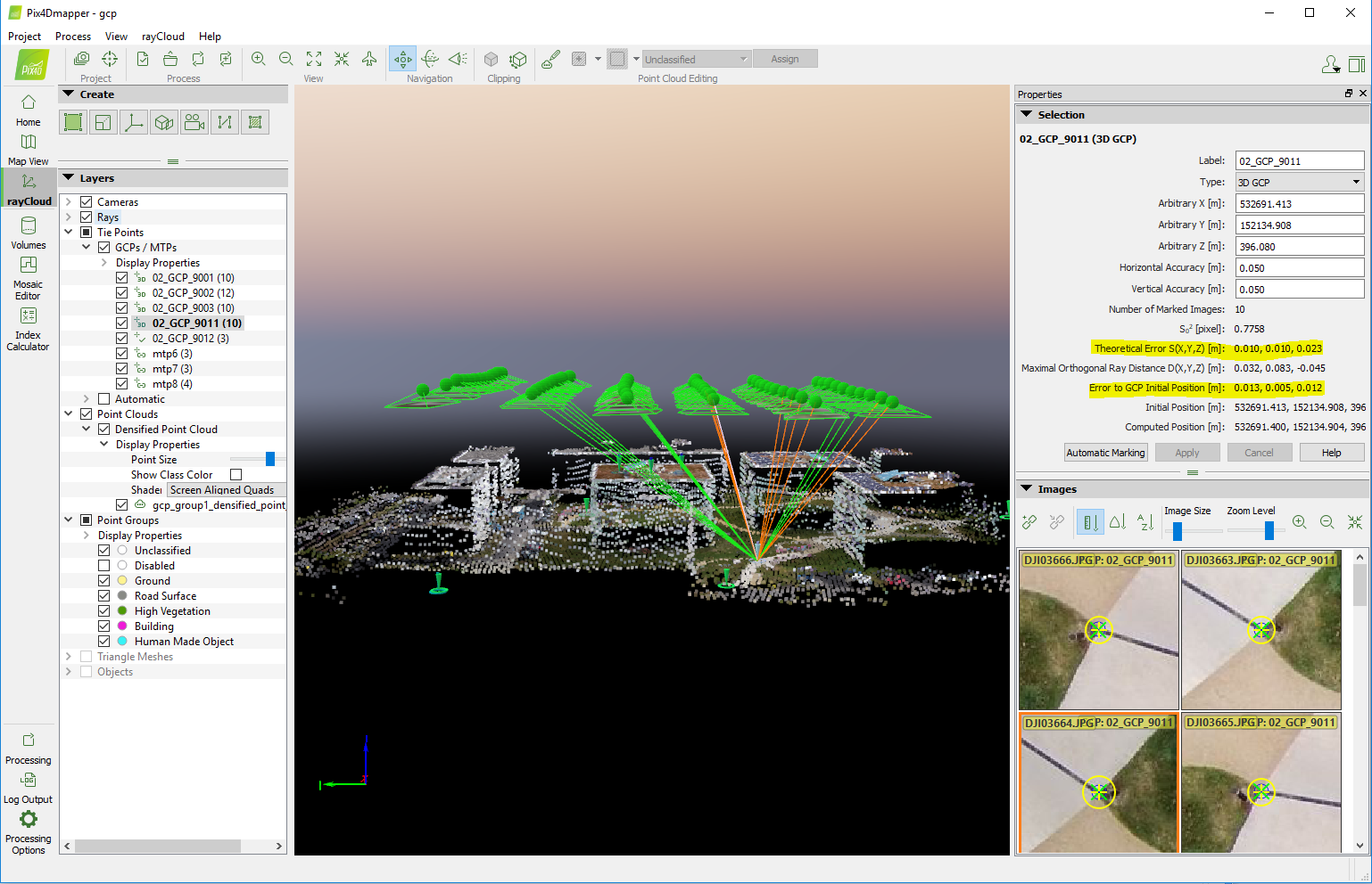

The Theoretical Error S(X,Y,Z) and Error to GCP Initial Position are computed after Step1 and they give a good estimation of the accuracy of the block.
The Theoretical Error S(X,Y,Z) informs us about the relative accuracy, whereas the Error to GCP Initial Position informs us about the absolute accuracy.
Note: A GCP can have a high Error to GCP Initial Position and a small Theoretical Error S(X,Y,Z). If that is the case, the point has been marked correctly on a sufficient number of images so that the relative accuracy is correct, but the GCP could be located far away from what it should be, which means that the absolute accuracy is not correct.

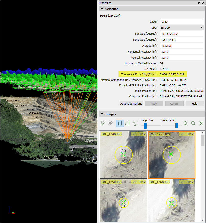

Theoretical error S(X,Y,Z)
The Theoretical Error S(X,Y,Z) defines the three error ellipsoid axes of a GCP, and does not consider the Initial (input) position of the GCP. It can be seen in the rayCloud when clicking on a point.
If the Theoretical Error S(X,Y,Z) is low, it means that the error ellipsoid for that particular GCP is small, so there is a good relative accuracy.

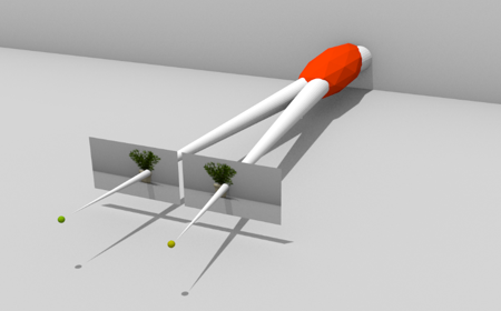

  • The GCP was marked in very few images
The image below shows a point that has been marked on only two images with a small baseline (the distance between the center of the images). As a result, there is a large Theoretical Error in the direction of the rays:

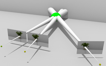

When the point is marked on a new image, the Theoretical Error gets smaller:

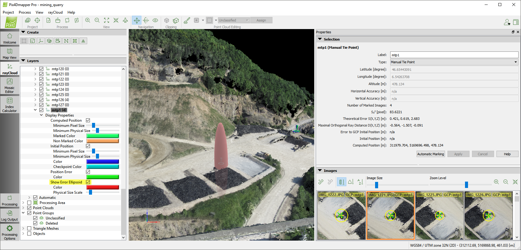

  • The GCP was wrongly marked in some images
The example below shows a point that has been marked on only 4 images with a small baseline, and on one of them (2), it is marked erroneously:

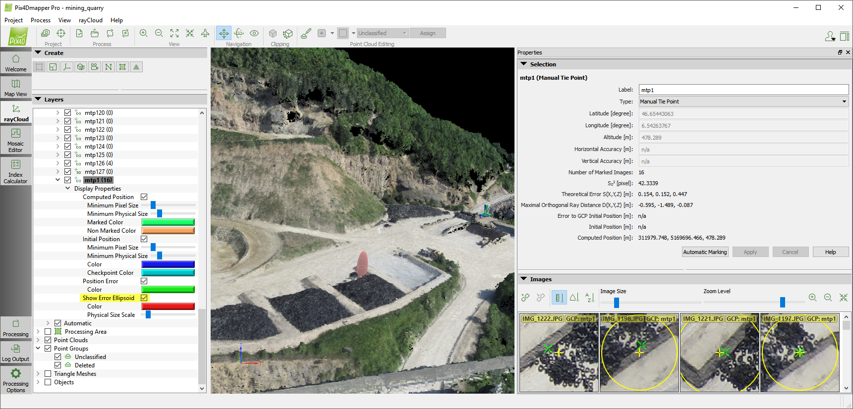

When the point is correctly marked on more images, the following result is obtained:

The Error to GCP Initial Position gives the difference between the initial and computed GCP position in each direction (X,Y,Z). If the error is low, it means that the project has a good absolute accuracy, whereas if it is high, it indicates problems with the georeference.
