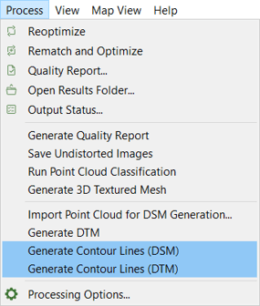

Access: On the menu bar, click
Process > Generate Contour Lines DSM or
DTM.
