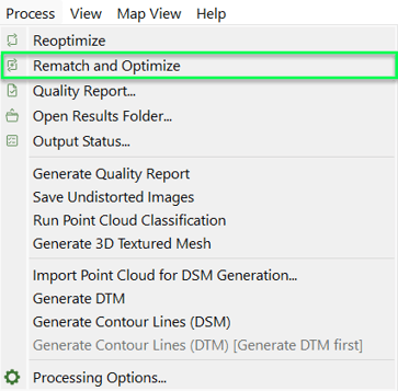

Access: On the Menu bar, click Process > Rematch and Optimize (enabled once step 1. Initial Processing has been completed).
PIX4Dmapper Rematch and Optimize
This process computes more matches between the images (and therefore more Automatic Tie Points), and reoptimizes the internal and external camera parameters. It is recommended to use it:
