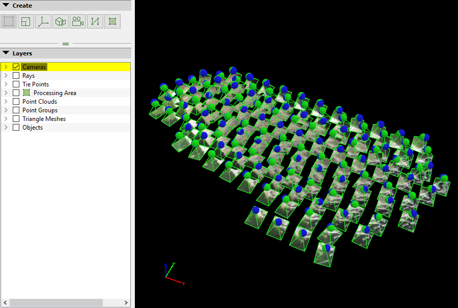

 Cameras
By default, the Camera layers are displayed on the 3D View as:
  • Blue sphere: Initial camera positions (GPS coordinates).
  • Green sphere: Optimized camera positions.
  • Red sphere: Initial camera positions (GPS coordinates) for Uncalibrated Cameras for which PIX4Dmapper could not find optimized positions and therefore were not used for the reconstruction.
  • Pale Red sphere: Initial camera positions (GPS coordinates) for Uncalibrated Cameras that were disabled by the user and were not used for the reconstruction.
  • Green line: Distance between initial and optimized positions.
  • Green lines: Projection lines between the optimized camera positions and the original image thumbnails.
  • Green squares: Borders of the original image thumbnails.

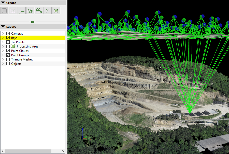

 Rays
By default, the rays can have the following colors:
  • Green rays: The rays that connect the selected 3D point and the calibrated cameras in which the 3D point was visible but not marked.
  • Orange rays: The rays that connect the selected 3D point and the calibrated cameras in which the 3D point was marked.
  • Red ray: The rays that connect the selected 3D point and the uncalibrated cameras.
  • Light Blue ray: The ray that connects the selected 3D point with the image that is currently selected in the Image View, and on which the point is visible but not marked.
  • Light Purple ray: The ray that connects the selected 3D point with the image that is currently selected in the Image View, and on which the point has not been marked.
Rays

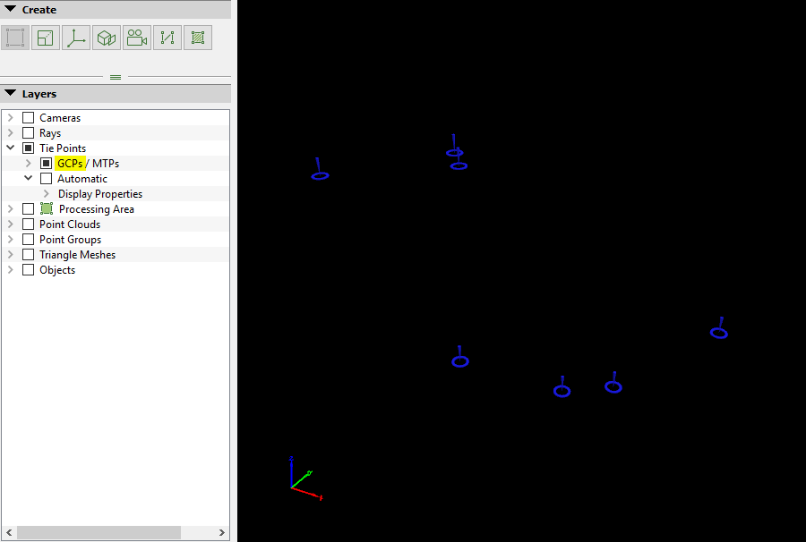

 Tie Points
By default, the Tie Points are displayed on the 3D View as:

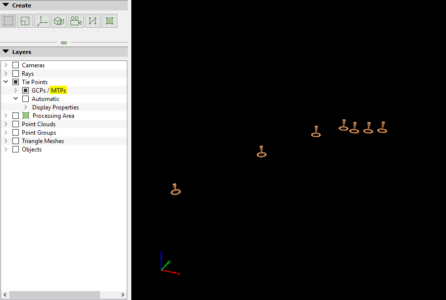

  • Green cone: Optimized position of Manual Tie Points, GCPs, Check Points, and vertices of the Objects drawn in the 3D View that are marked in at least 2 images.
  • Orange cone: Vertices of the Objects drawn in the 3D View that are marked in less than 2 images.
  • Blue cone: Original position of GCPs and Check Points.
  • Colored point: Automatic tie point computed at step 1. Initial Processing colored using the original images.
Manual Tie Points
GCPs
Automatic Tie Points

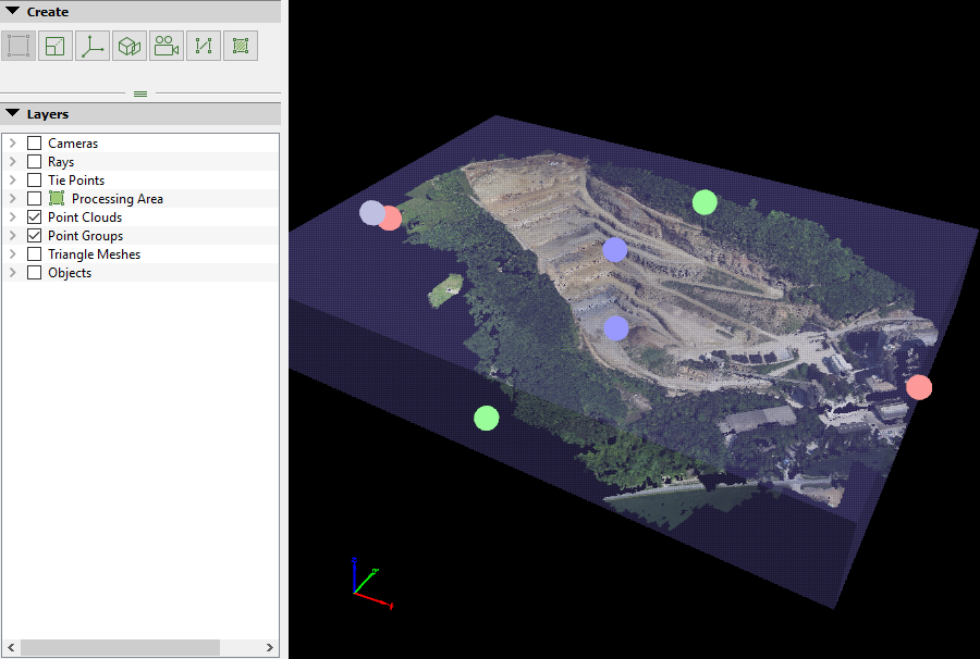

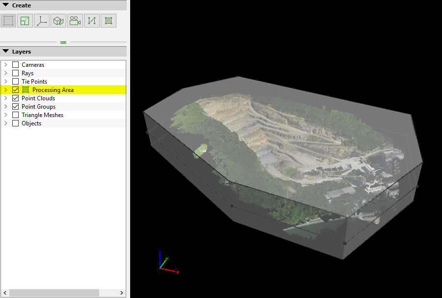

 Processing Area
By default, a Processing Area is displayed on the 3D View as:
  • Gray spheres: Vertices of the middle plane of the 3D Processing Area.
  • Gray lines: Lines between the vertices of the planes (bottom, middle, and top planes) of the 3D Processing Area.
  • Transparent gray planes: Top, bottom, and side planes that form the 3D Processing Area.
  • Transparent light gray planes: Top, bottom, and side planes that form the 3D Processing Area when hovering over the area in the 3D View.
  • White lines: Lines between the vertices of the planes (bottom, middle, and top planes) of the 3D Processing Area when selecting the area in the 3D View.
Processing Area

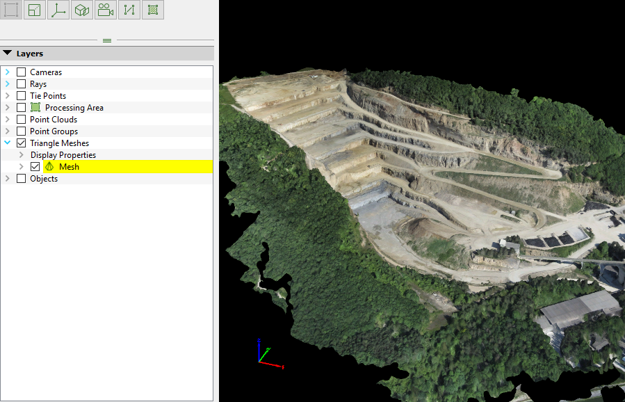

 Triangle Meshes
By default, the 3D Textured Mesh is displayed using the Texture shader and other triangle meshes are displayed using the Monochrome shader with gray color. For more information about the Display Options of the Triangle Meshes: Menu View > rayCloud > Left sidebar > Layers > Triangle Meshes .
Triangle Mesh

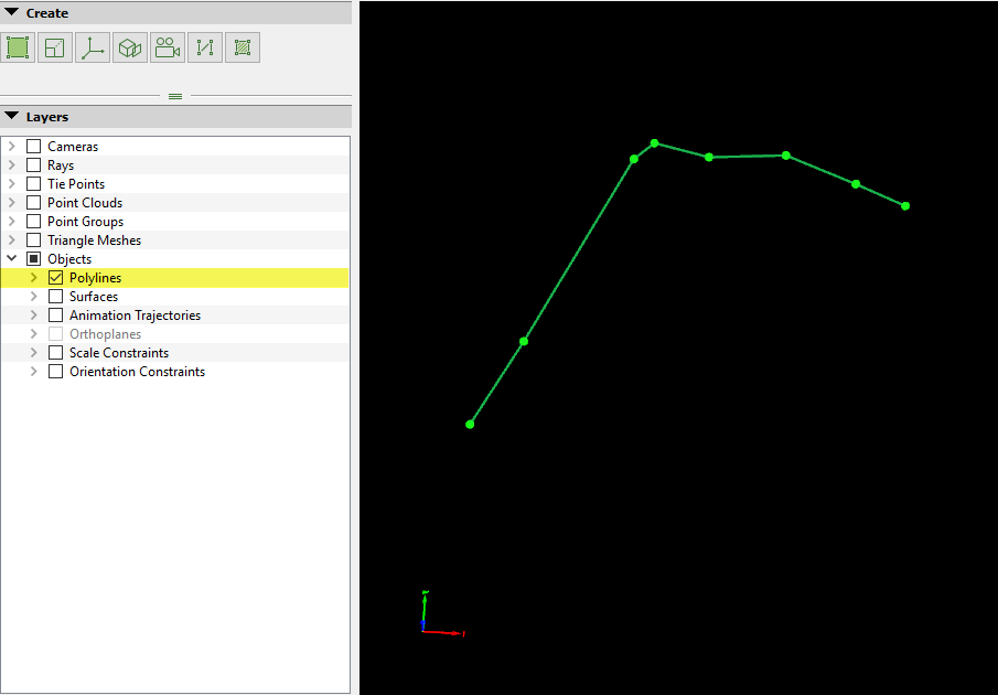

  • For Polylines, Surfaces and Video AnimationTrajectories:

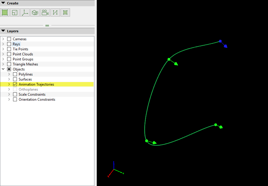

    • Green sphere: Object vertices for Polylines and Surfaces. Waypoints for Animation Trajectories.
    • Green Arrow: Orientation of the camera in the waypoint (only for Animation Trajectories).
    • Blue sphere: First Waypoint in Animation Trajectories (only for Animation Trajectories).
    • Blue Arrow: Orientation of the camera in the first waypoint (only for Animation Trajectories).

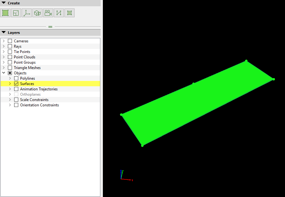

    • Green surface: Base surface for Surfaces.
    • Green lines: Lines between vertices/waypoints from the same object. For Polylines, Surfaces and Animation Trajectories.

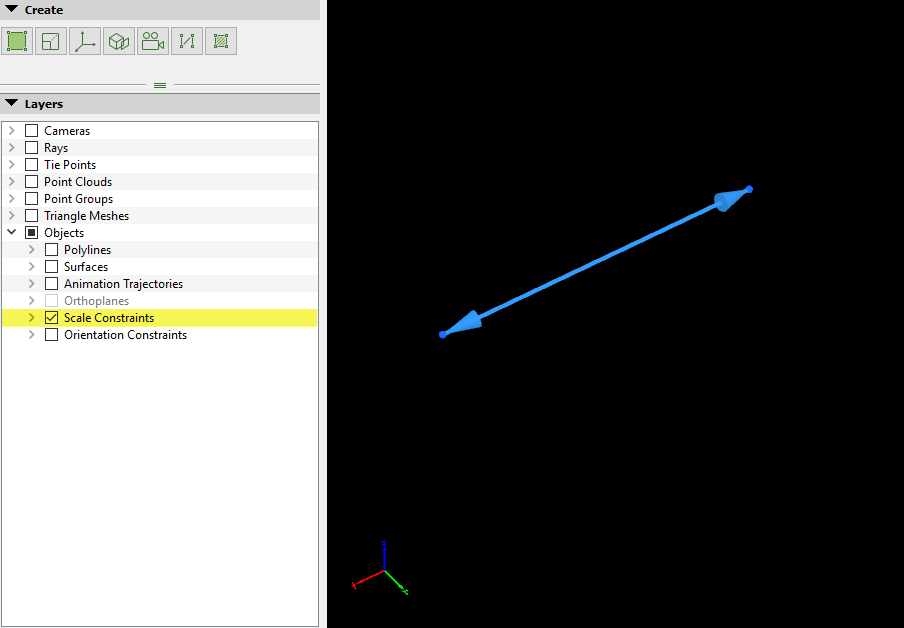

  • For Scale Constraints:
    • Light Blue double arrow: Scale Constraints.

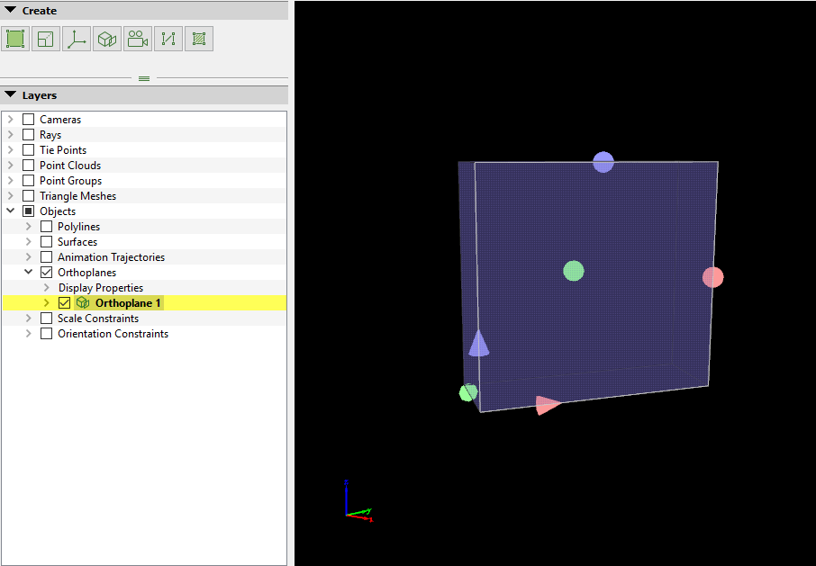

  • For Orthoplanes:
    • Red sphere: Allows to increase the 3D orthoplane in the X dimension.
    • Blue sphere: Allows to increase the 3D orthoplane in the Y dimension.
    • Green sphere: Allows to increase the 3D orthoplane in the Z dimension.
    • Red cone: Allows to move the 3D orthoplane in the X dimension.
    • Blue cone: Allows to move the 3D orthoplane in the Y dimension.
    • Green cone: Allows to move the 3D orthoplane in the Z dimension.
    • Gray lines: Lines between the vertices of the planes of the 3D orthoplane.
    • Light gray lines: Defines the frontal surface of the 3D orthoplane (face that will be mapped).
    • Transparent light blue planes: Side planes that form the 3D orthoplane.
